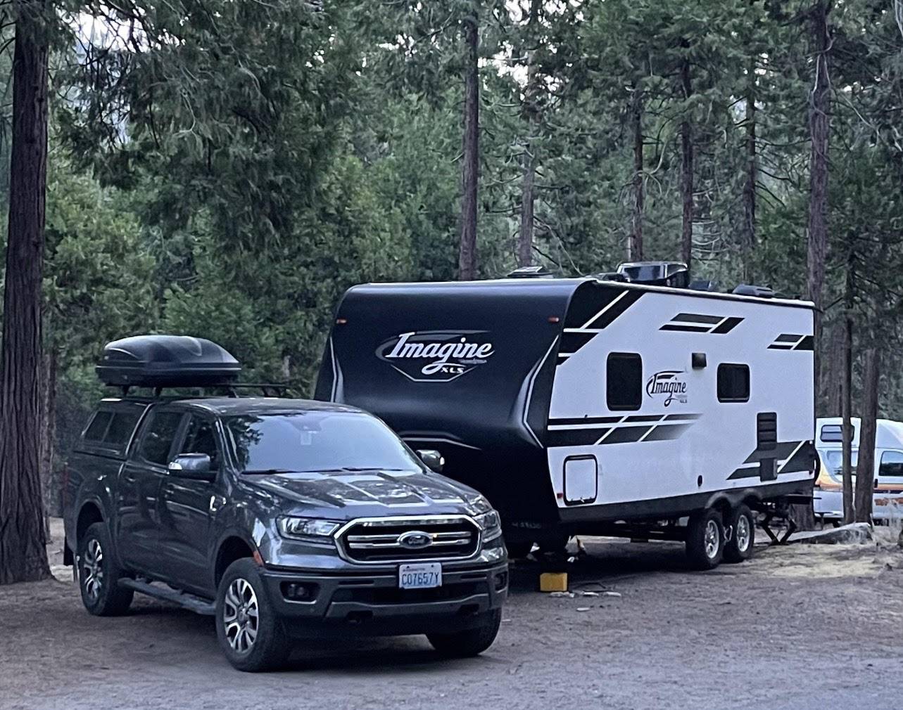

Looking for some answers and or advice. I have a 2019 ranger lariat with tow package, 7500# tow rating. While on the first day of a 2,800 mile trip with my 22' 5000 lb dry & about 6,500 loaded trailer through Washington, Oregon, California and back. Only 200 miles into the trip I felt a weird shuttering of the transmission or engine, I was traveling on flat ground interstate 5 at about 75 mph on a 75 degree day, my foot was in it pretty good up to this point and I figured I may be in limp mode or something from hammering too hard, I backed off and drove like a normal person for the rest of the day , I did pull over and look underneath and noticed I burped out some tranny fluid. Finished my 500 mile trek to Crescent city and the next day had a shop put it up and check the fluid. They could not find the vent if there is one but did notice the wet fluid underneath. They found the dip stick checked the fluid and topped it off, the fluid was still pink and the tranny only took a small fraction of a quart, hardly nothing at all. They saw no problems or reason for me to do anything further since it was driving normal. I did an additional 2,200 miles over the next 3 weeks over major mountain passes like Tioga at 10,000' elevation and several more 8000' passes with zero issues and the tranny shifted like butter. I was easy on it the rest of the trip.

Thank you for the reply, one thing is the fluid that burped out sprayed all over the underneath rear bumper and from of the trailer RV so I knew it was fresh. Looks like it burped out about 1/10th of a quart at 75 mph so it then just got blown everywhere and looked way worse than it was. I was unsure how much leaked out until the next day at a shop where they tried to put more in and it didn’t need hardly anything. But the leak was fresh with even a few pink drips lingering.

Yeah I wondered about maybe it was overfilled. Especially since it happened on flat freeway in 75 degree temps and then I did another 2000 miles over mountain passes with zero issues. Couldn’t really go any easier when trying to maintain a reasonable speed up long grades so I figured if I had an overheating issue it would surly happen again but it didn’t.
