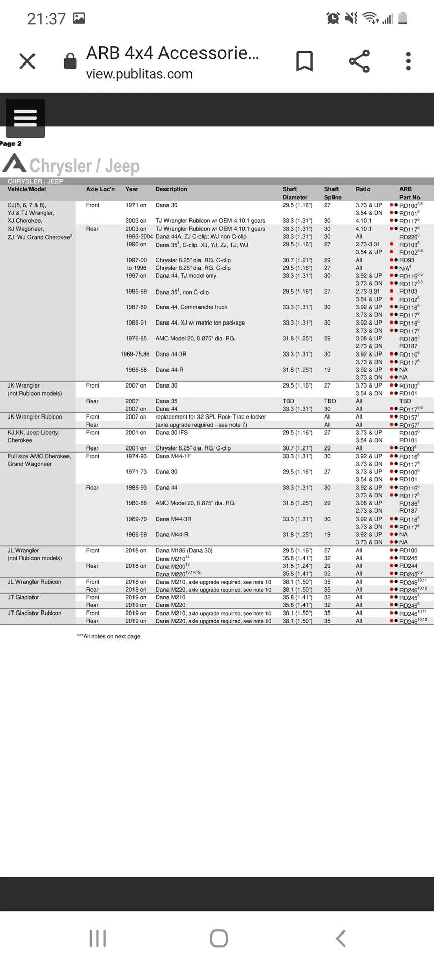

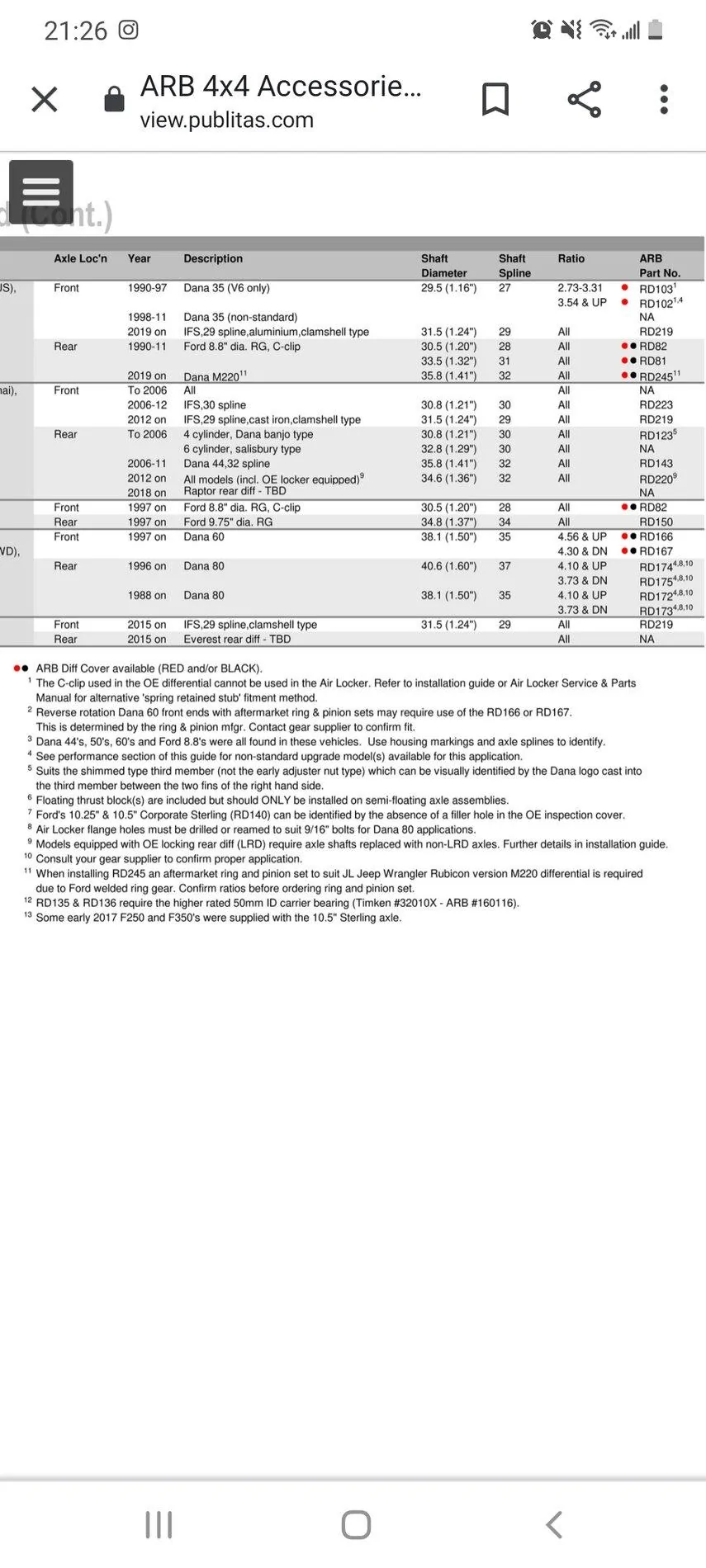

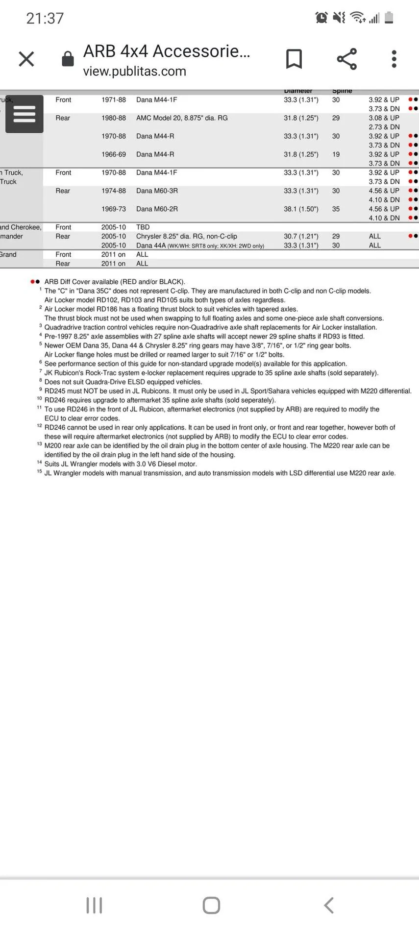

So if I'm reading ARB's data correctly, would these screen shots not indicate that the lsd could be interchangable between a jl jeep wrangler non-rubicon and the ford ranger? Has the same spline count (32) and works for all ratios.
