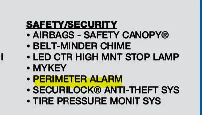

How can I tell if the Perimeter Alarm is already installed? I have the fully loaded Lariat, with remote start.
Seems like a good idea to add this, if it's not already installed.
On your window sticker...

thank you! I just checked my window sticker and I already have the Perm alarm :)

That’s not a shock sensor alarm. Only if someone opens the door according to dealership. I bought an alarm kit to add shock sensor from the Ford website and my dealership says it won’t work on a 19 Ranger even though website says it will.
