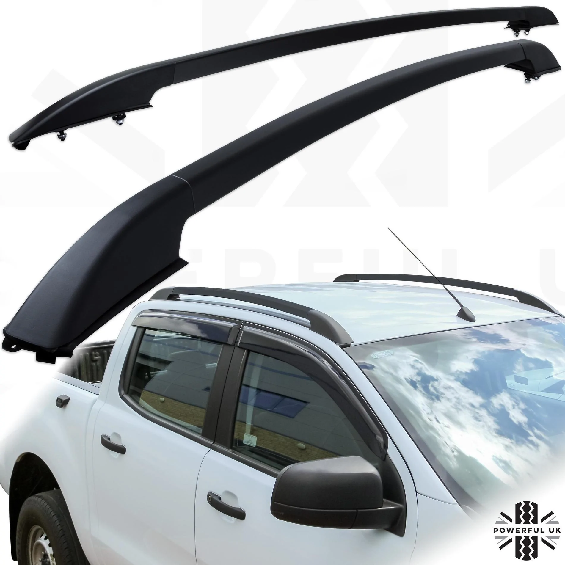

These Roof Rails look pretty slick... https://www.powerfuluk.com/vehicles...ord-ranger-2012-on-roof-rack-rails-black.html
These OEM style rails should allow for any typical (yakima, thule, etc.) crossbars to grab on in order to mount just about anything.

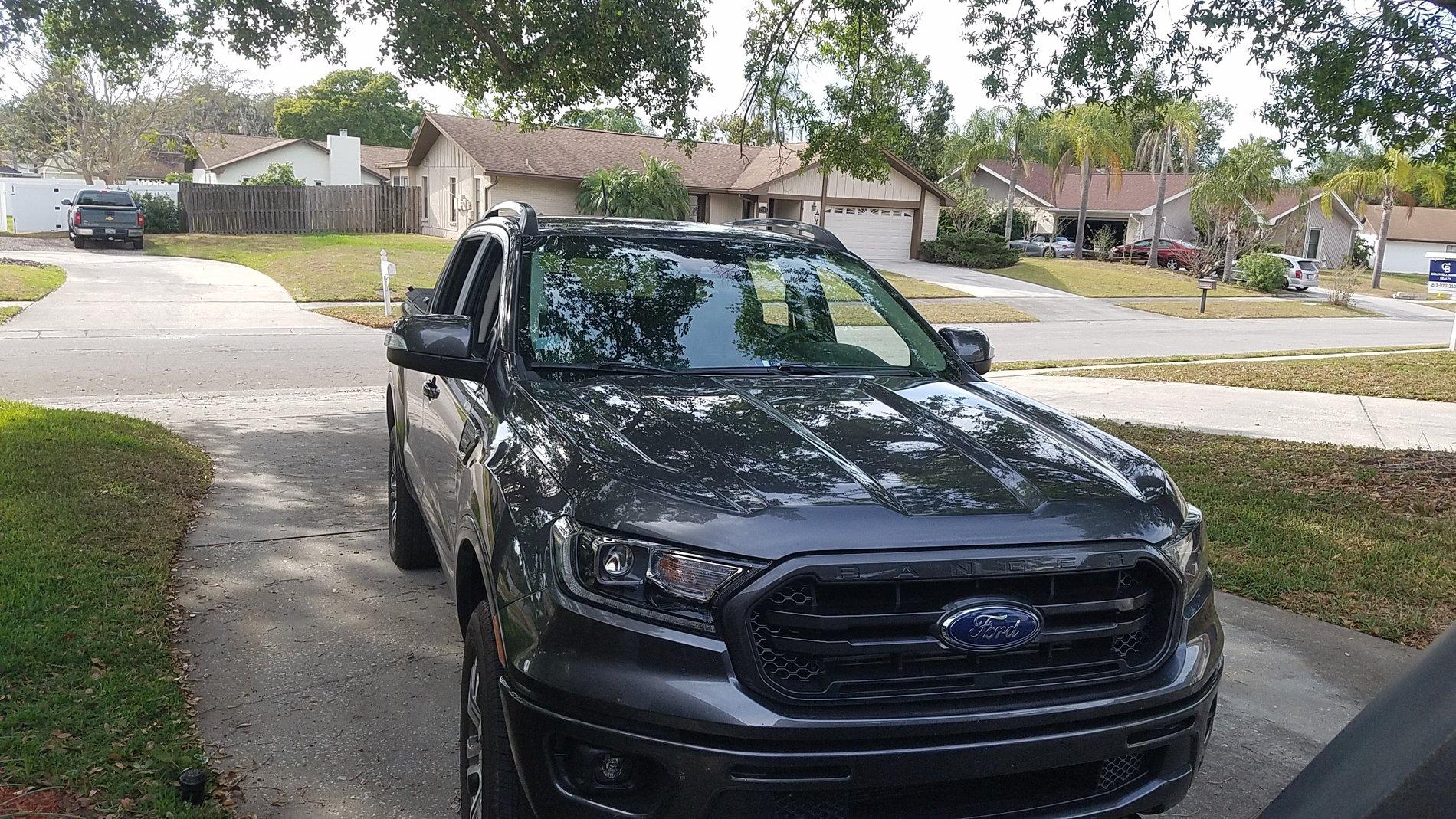

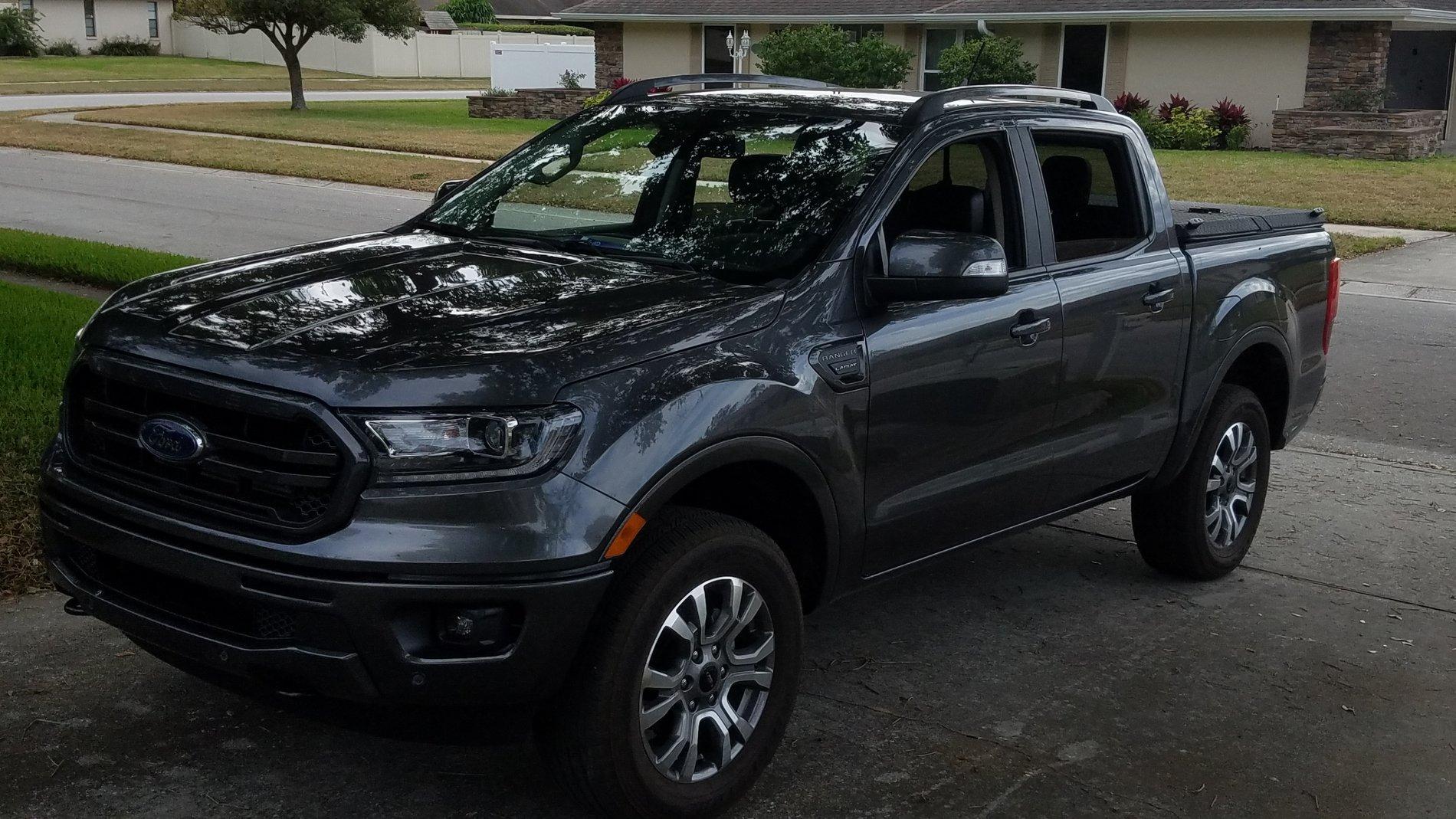

Not great light, but proof of progress!
Powder coater did great job with color. The rails I've ordered are bright, might have them taken to gloss black. Gotta see them 1st.

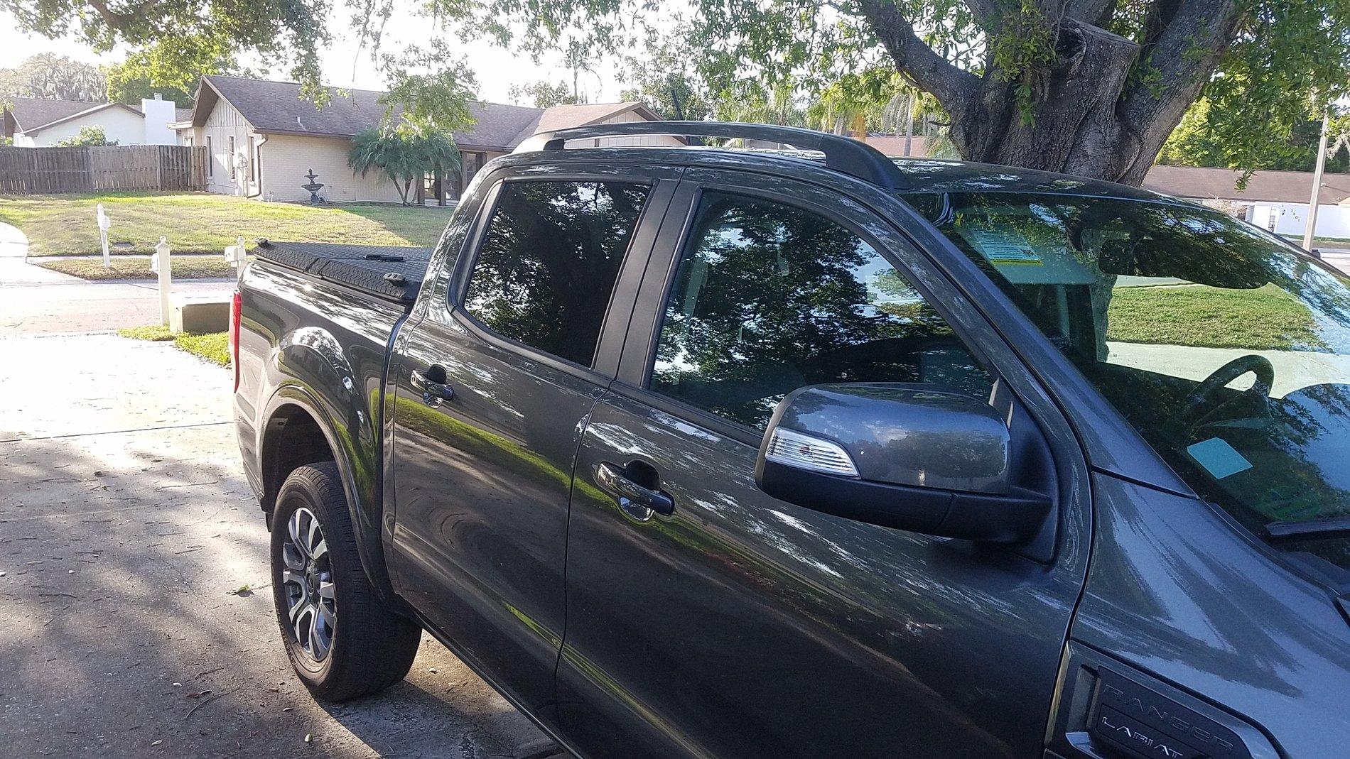

And second rail is on!!
I know it't not everyone's path, but works for me and my need to carry ladders and other "long things" without a utilitarian ladder rack.
Looking forward to getting the cross bars and fully functional.

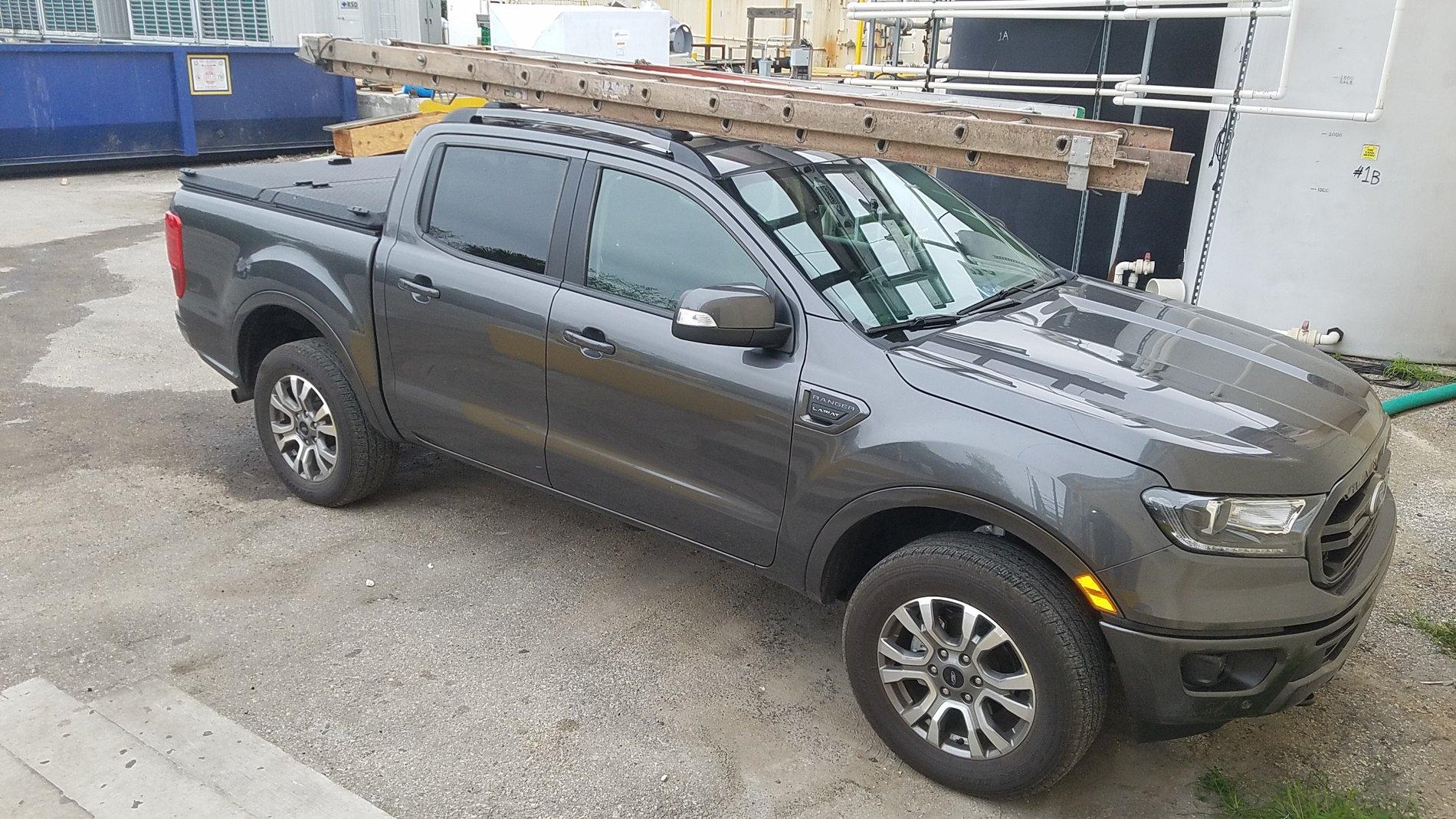

And the Ranger goes to work!
Cross bars from Amazon are dead straight, curved would probably be stronger and better follow curve of roof
One surprise was how much wider the Wildtrak rails are in the front. About 2", had to narrow the rear rail to get it to fit.
Next task is to make some rail stops to better tie down and locate the ladders and such.

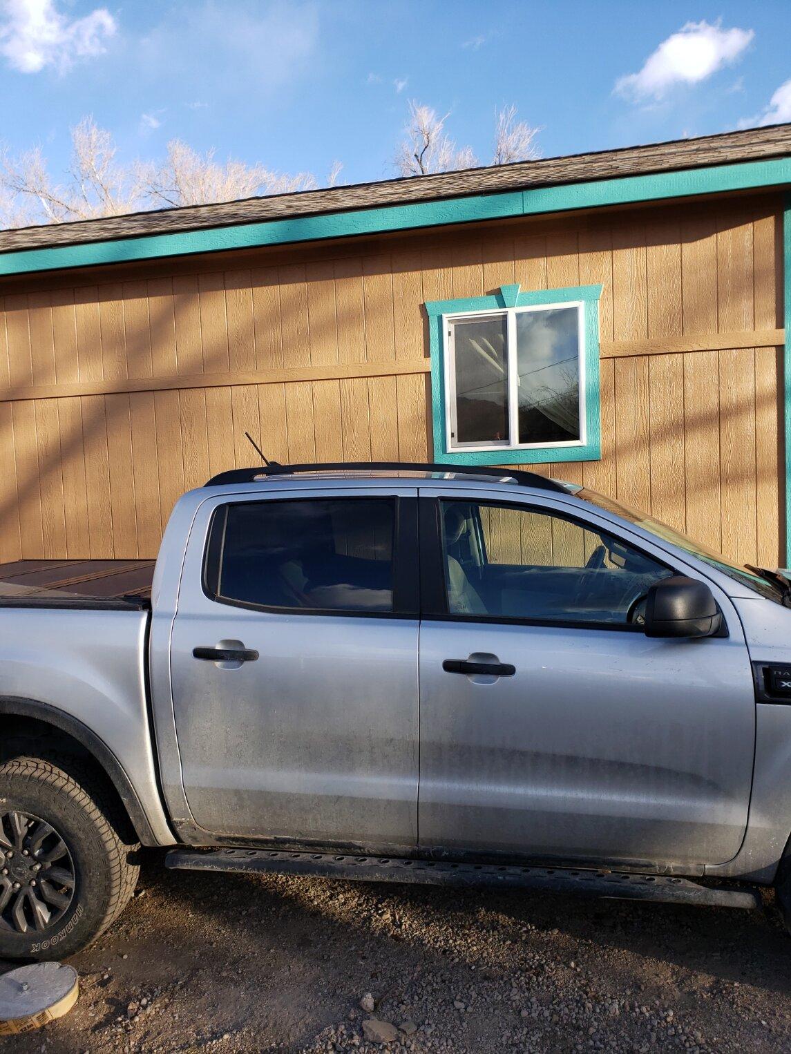

like @SOHK_Alumni ... one side at a time. Had difficulty with how the bolts aligned on the inside of the cab. there are 2 layers of metal ... had to find a way to make the access hole bigger with one of the front bolts. So, long project longer, I'll do the other side another time. Liking that it's a fairly low profile rail.
