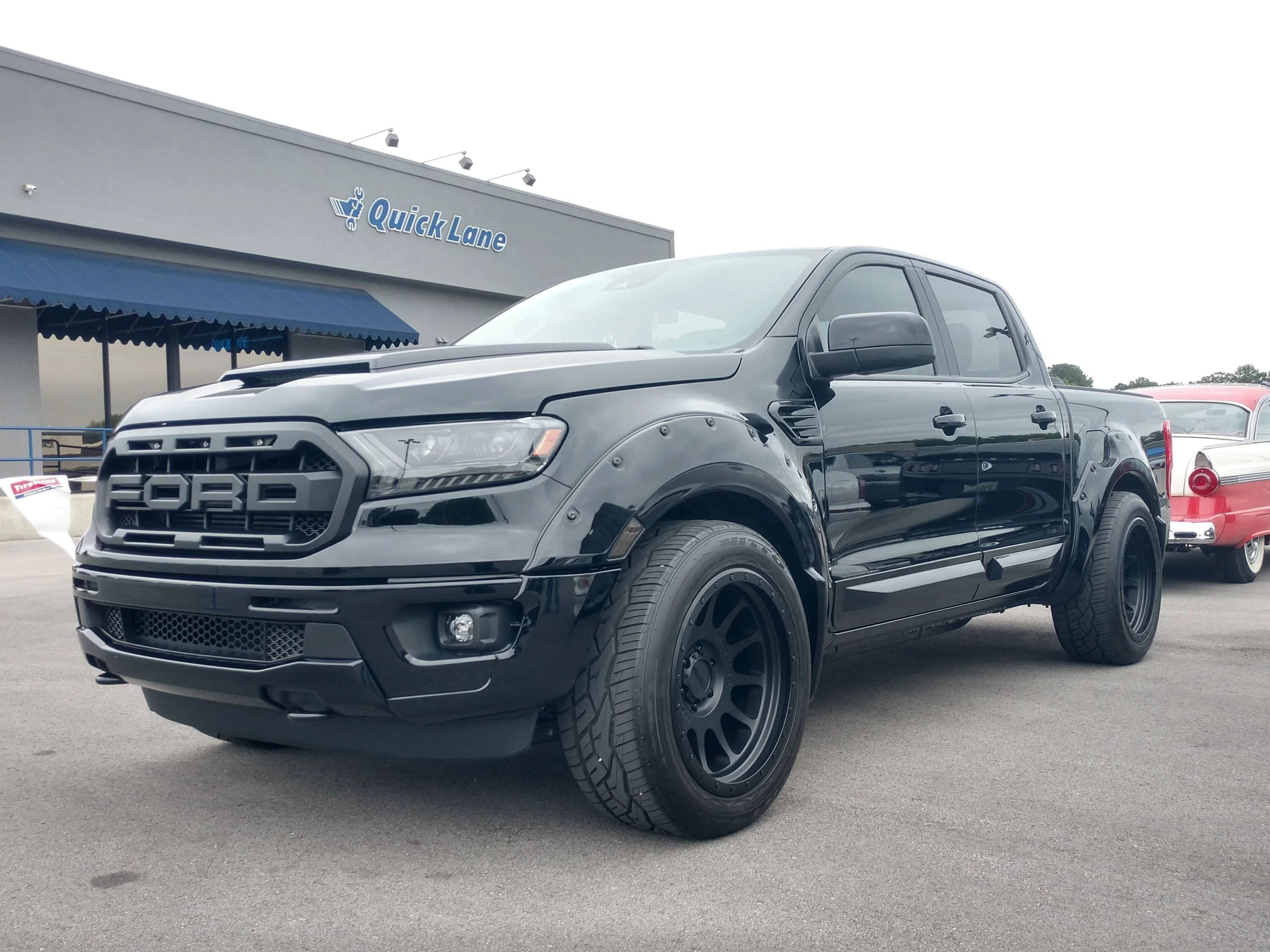

Finally did it today. I bought the whole Belltech kit over a year ago including control arms. I did the whole swap today on the ground, but I was a tech in a past life. I had my cordless impact which made it go quick. My Ranger is an FX2 so I could get the locker. Unfortunately it utilizes higher ride height springs so the effective lowering is less than usual, but my tire change (295/35/18 Toyo Proxes) made up the difference. I lowered Fr 2.75" R 4" but I will be changing to 5" rear as a rake of 1.4" still exists. The kit went on smoothly save for missing bolts that I had to procure. Just waiting on my Airdesign flares to come in now.
I wont be acquiring regular ride height rated springs as I am a mountainbiker and I live in the mountains so I need to retain some semblance of ground clearance.

Would love to see a complete side shot to see what it looks like squatted down. I can’t really get a sense of that in the 3/4 view.
Ditto....the dark color and the background make it look like you posted the pre-lowered pics. The 1.4" rake difference looks like 6".....TWSS :p

ill try to take pics another day and repost. I was beat and just snapped a few quick pics and oh here is the tire comparison. Sorrys its an extremely brief movie :p The old tire/rim was pressed against the new one, but it looks all messed up perspective wise. The new tire is 25.8" ground to top of tire. The old tire was 30.2" ground to top. This made my effective rear ratio 4.27. Yes it is noticeable. I would say going higher would even be of benefit. I think at 70 I was at 2200-2300 rpm in 10th gear, which is more accessible now. Previously I rarely used 10th as highest the speed limit where I drive is 65. GSP don't mess around so I rarely speed anymore.

It's nice to see another lowered Black Crew Cab :) Looks like you're trying to clone my truck :D
I have about a 3" drop up front and a 5" rear drop, but my wheel/tire combo is a bit different from yours, as I don't have as much of a gap between my fender lip and top of tire. Also, mine is just a 2wd, not an FX2.

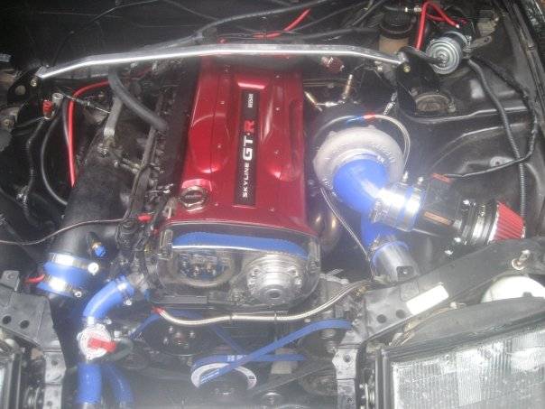

As far as I know Im the first person in the world that I know of to put an rb26 into a 300zx tt Only took this one pic its on my fb from 2009 but The car was already long gone. I did it in 07 and sold it after the auto industry went tits up. Everyone started claiming afterwards that they were first but they no one did it until after I answered some questions on a forum and let all the secrets out. I should have opened a shop and kept my mouth shut. I havent seen one with ac besides mine though :p It had a gt35r on it, stock 5spd 300zx mated to the rb. I did the wiring myself and used the eraliest ghetto as tuningI was a tech for Nissan and Subaru early on so ive done several crazy things with sr20s, I did 3 rotary engines(I will NEVER EVER do another), 4 Honda builds, 9 mustangs, 3 Camaros. I love the way rotaries sound, but Jesus those things are like literally burning money to move. If you know rotaries I did 2 rb13 and an na 3 rotor from a cosmo. There is a guy now that has perfected a 4 rotor. I would bet he is has over 100k in the engine project alone. I feel like Modern American muscle cars are dead AF to me. They make the power; but to sacrifice that cam sound for improved drivability and emissions hurts me.
