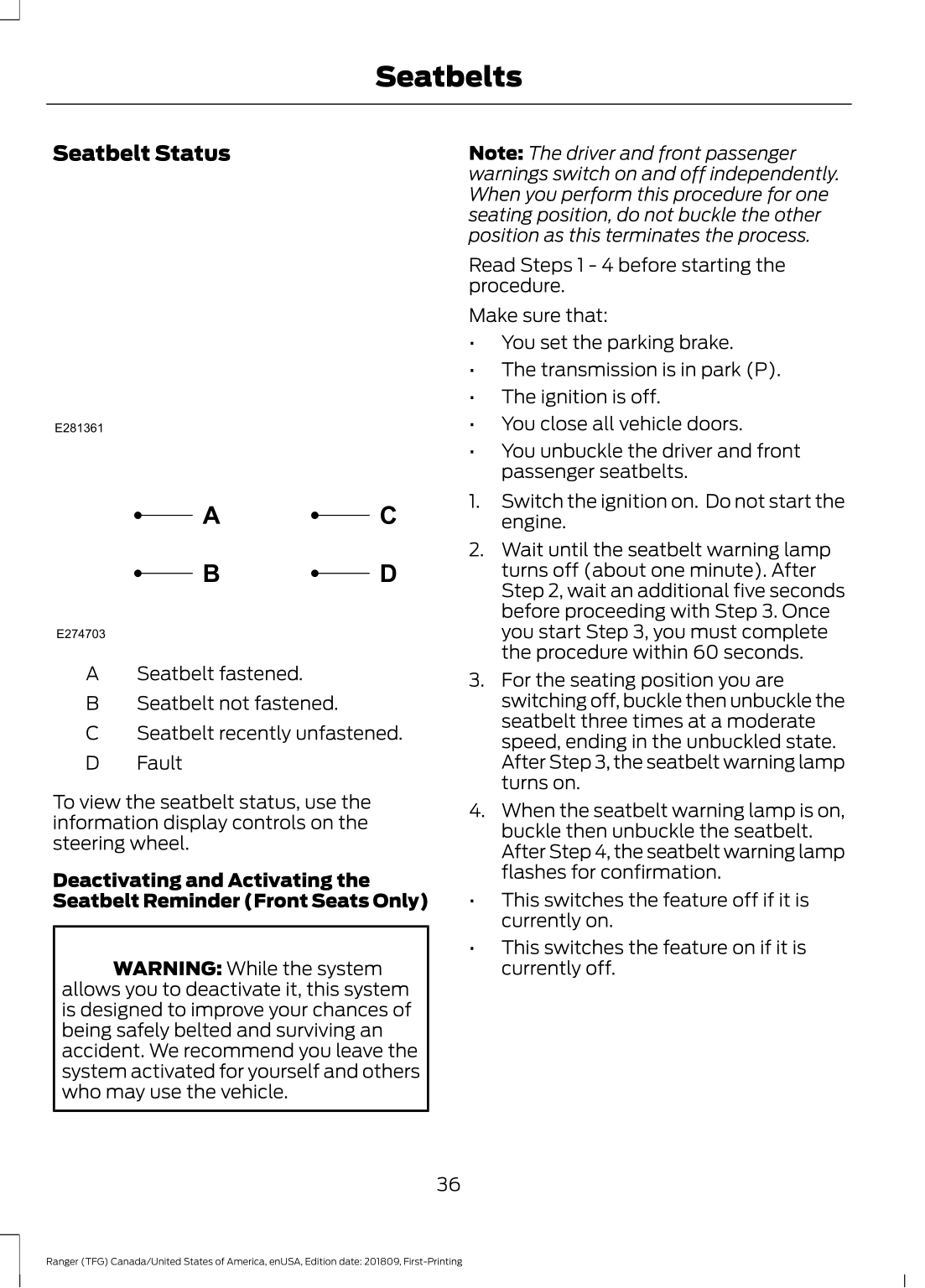

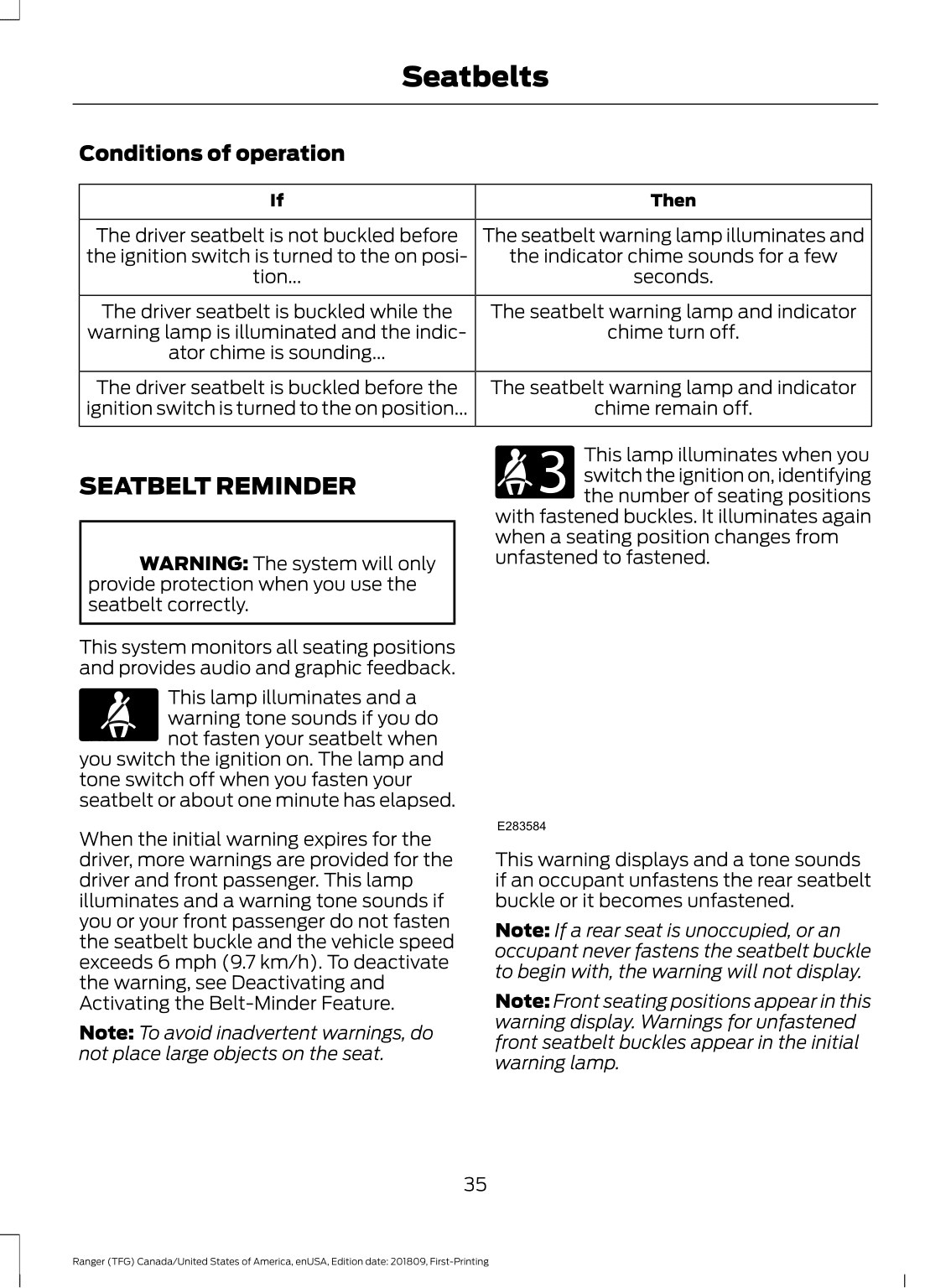

Like the seat belt chime? I believe you can disable the chime for front seats only.
