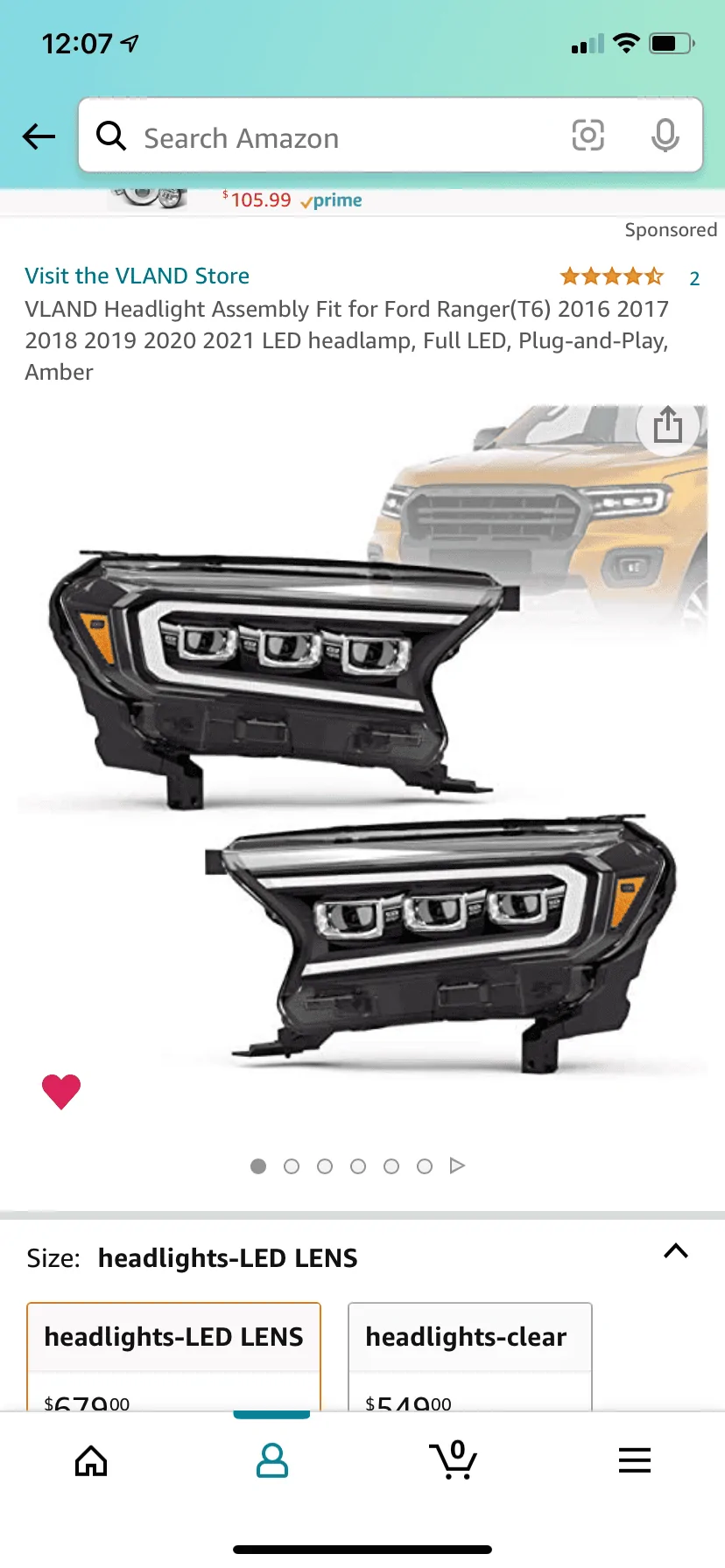

I know there’s other threads about the mustang style ROW headlights fitted to US Rangers, but I’m not personally the biggest fan of those to be honest. This style looks a little better to me. Who has fitted/wired these up or something similar? And just save your “those won’t fit “comments because you “heard” they would not. Looking for input from those who have actually done it. Thanks!

Well ok I get what you are saying and yes they’re probably not actually “DOT certified“ whuch means they have not been tested in the US which probably also means they are properly bright, as they should be...
A whole bunch of “DOT certified “new vehicle headlight assemblies are failing the brightness tests in the US.
But yes that’s why this Chinese company bothers to put it on there because it gives folks a warm and fuzzy to see that they are “DOT certified”

Save yourself a ton of problems and spend a little more on a set of Alpharex lights. Then you will know they fit and plug in, a number have already done it. And they really do meet US standards.
OK you may very well be correct. However, what do we really know about AlphaRex? We have a few guys on here running them I believe. How are they holding up? Are they really a better quality product? They’re made in China just like everything else.
Alpharex is a known lighting company in the auto industry for many years. And having as you put it A FEW guys running them is certainly better than none. At least you can know they will fit without modification and will be plug and play electrically. Also they aren't toting some bogus certification certificate. Just not worth the risk for really not that much more money. I do agree the Lariat lights are ridiculous in price even used.

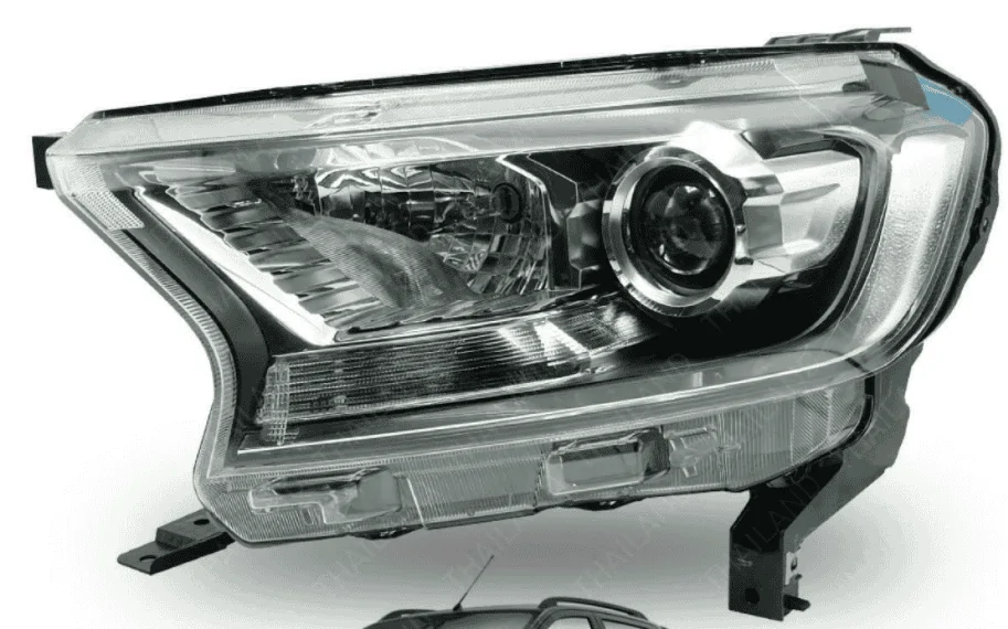

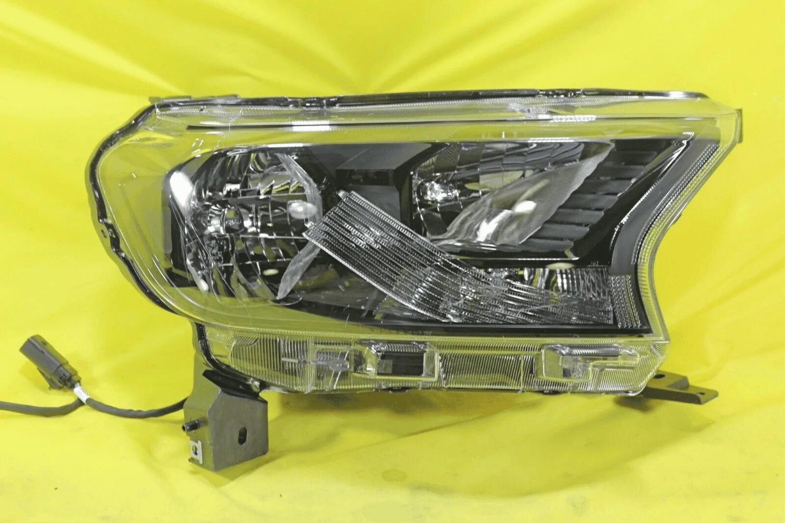

ROW lights will not fit a US-spec Ranger without some surgery. The outside lower mounting tab is not in the same place. The US light's tab protrudes outwards, whereas the tab on the ROW light is pulled in. The ROW Ranger doesn't have the same front bumper and valence that the US Ranger has so things aren't quite in the same place.
US:
ROW:
US:
ROW:
Yes I know the lower mounting tab would have be left off or some fabing done for it to bolt up. Yes I know some wiring would have to be done as well. The body outlines however matchup.

Well I think you guys are right. For as much is these cost and how difficult they are to mount, and if one LED goes out then you’re buying a whole new set of lights and any kind of support will be nonexistent, the risk of them being pieces of shit is too great.
