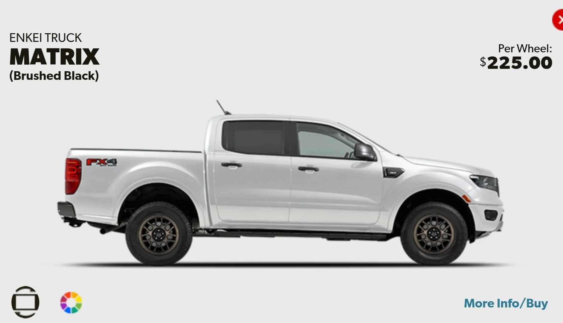

I'd love to see real world pictures of those. I only have the tire rack mockup...
