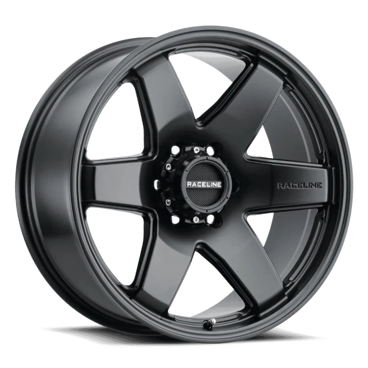

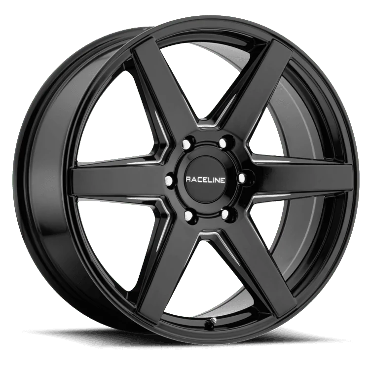

Just came across an option you may want to consider @RangerGuy2019 which is the Raceline 942B Addict.
This model comes in 18x8 ET+35 so when compared to where the factory wheels sit now, the 942B Addict will sit less than 1-inch further out (20mm to be exact). The Raceline Surge also comes in the same dimensions.

Just came across an option you may want to consider @BDoc which is the Raceline 942B Addict.
942B Addict
156B Surge
Appreciate the input, but you may want to direct this at the OP @RangerGuy2019 since he's the one looking for 18" rims. That said, I do like those 942's :like:
