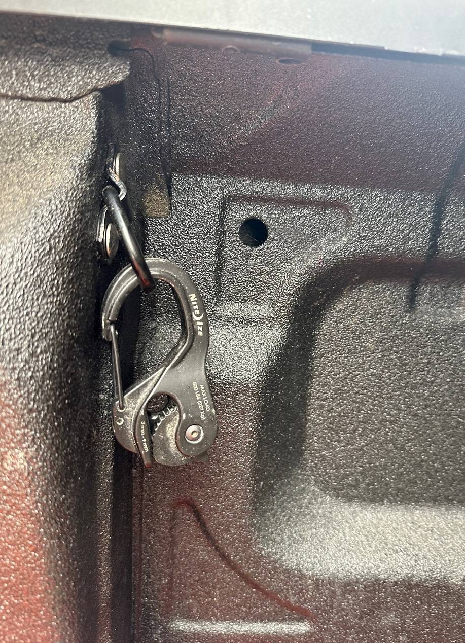

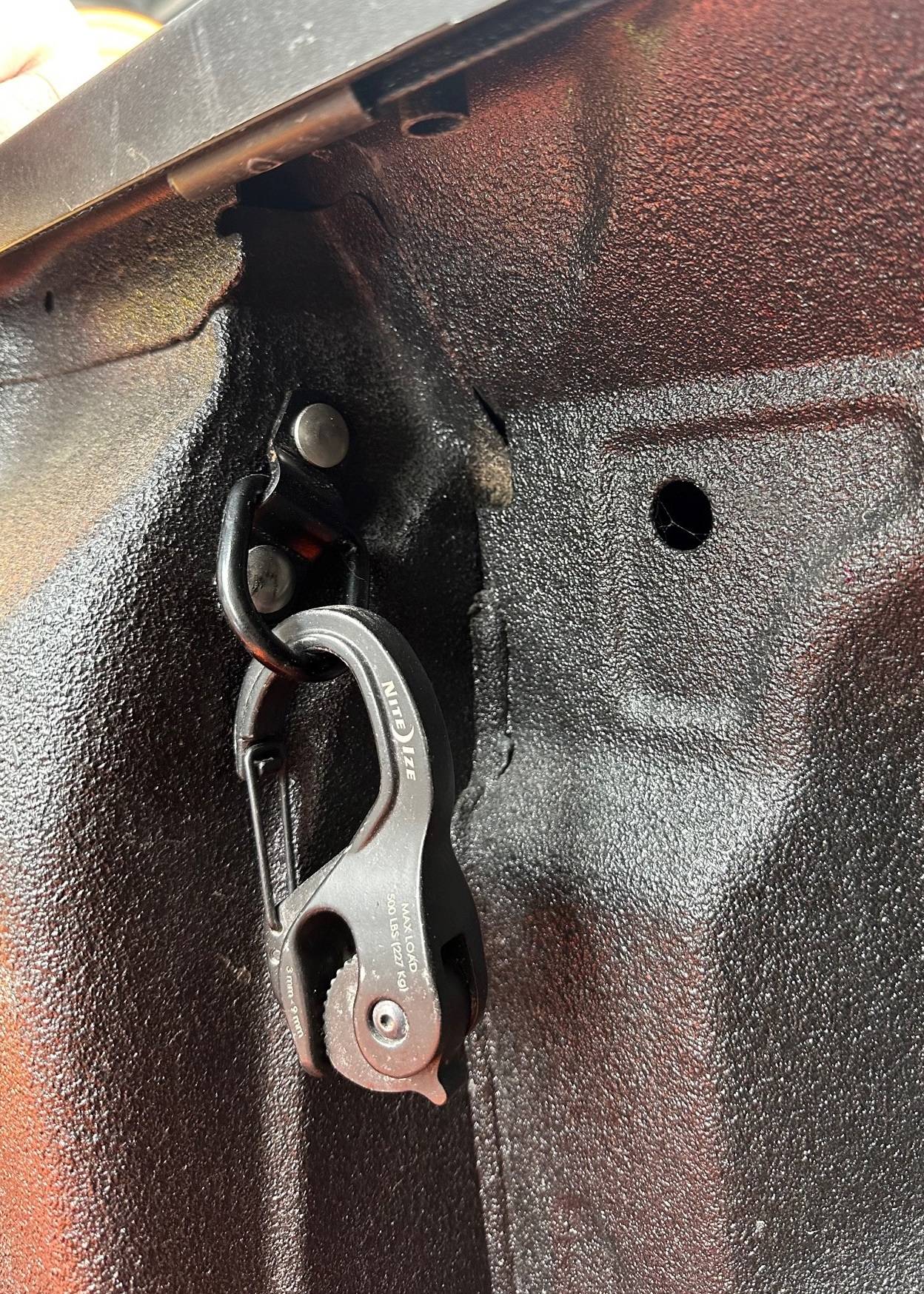

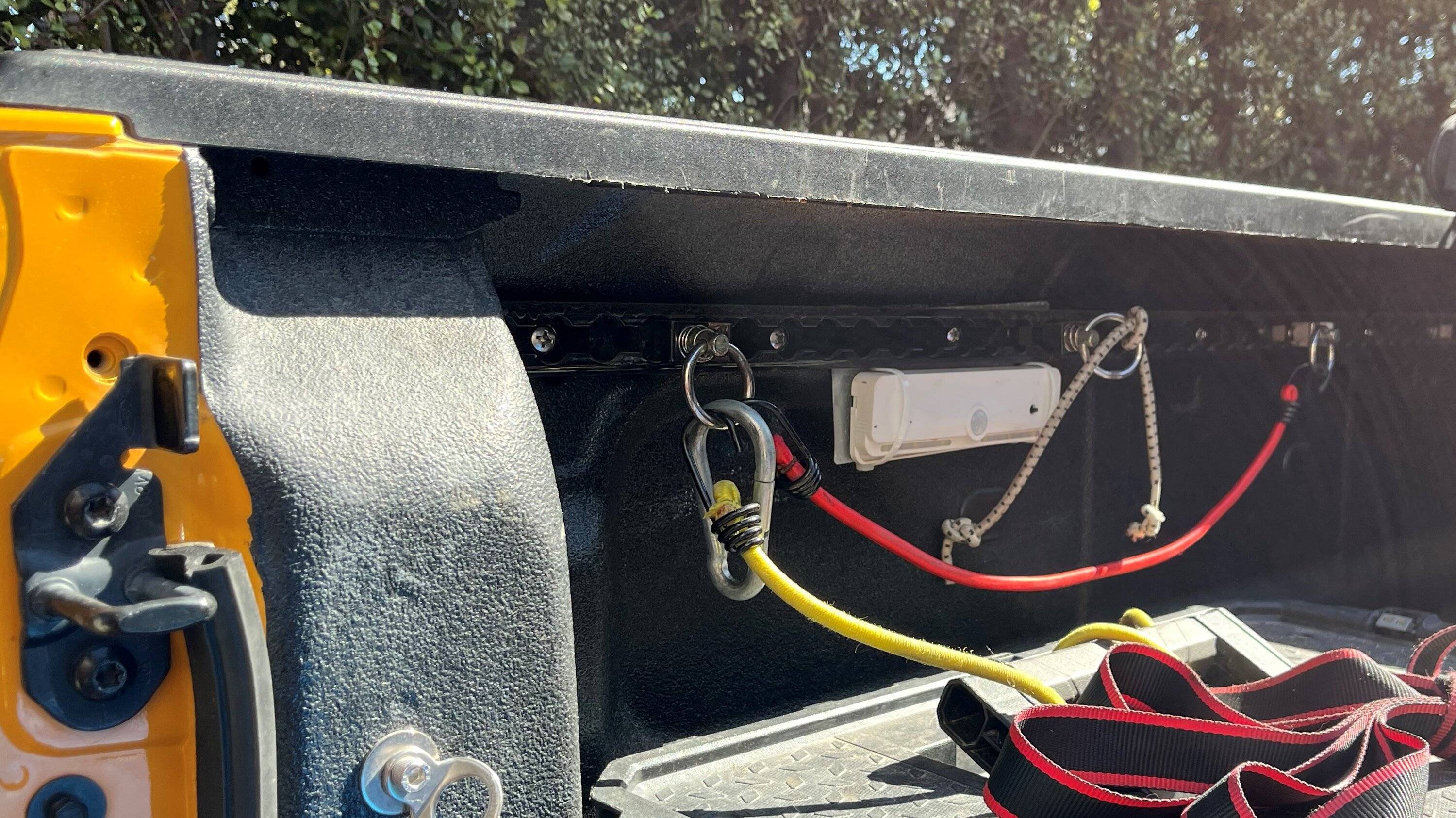

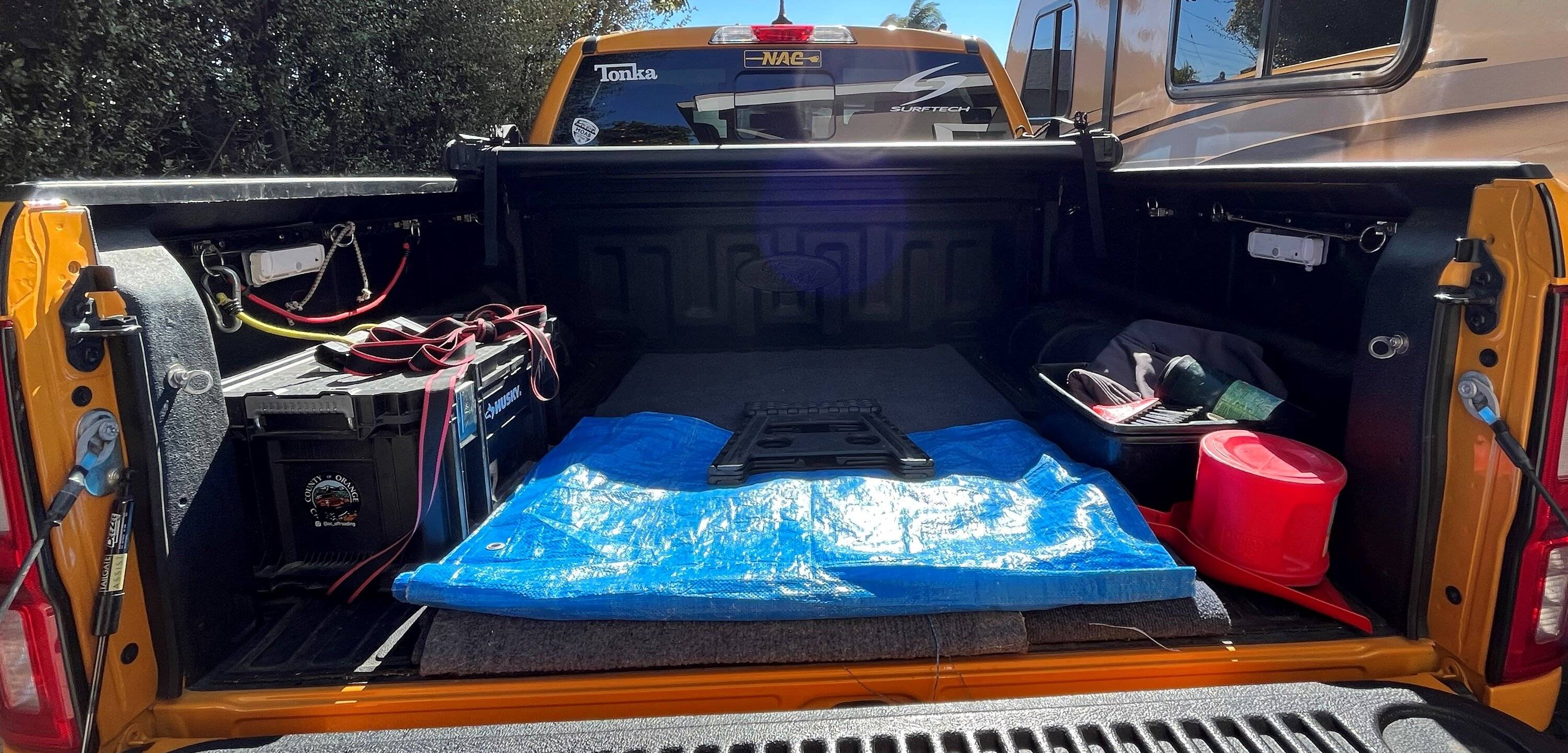

I like to have high mounted anchors points for load stabilization of taller items, such as the 5 gallon tall gas cans. These are not going to be used for 1,000 lb loads, just stabilizing top end tipping issues. I'd like something along the side wall of the box, as well, but being just sheet metal there is limited value. I added these to the forward side of the rear pillar. Basic welded D rings from Amazon, but I had to square the holes to use carriage bolts. On the back side I used ny-locks, with a regular 3/8 washer over a 1&1/2" fender washer. I also used a dollop of sealant to help control oxidation.
I actually installed these a few months ago, but didn't take photos at the time. I used them today to secure some 8 foot PVC pipe. I had some smaller items in the box, so I left the tailgate up, and used 3/8 rope looped around them just to prevent side movement. The Nite Ize Aluminum Cam Locks also work great for this type of application on light to medium loads.

What's up with the top-mounted tie-downs in the front of the bed?
Are there actually mounting points for those? I'd take a look but it's covered with a BedRug. If so, looks like something else for me to order!
Those holes are factory, and the same bolt size as the tie down points. The spacing on the holes is about 1/8" shorter than the tie down brackets, so I do not believe that is the intent. IIRC someone mentioned they are for a tonneau cover or other FORD accesory mounting location. I elongated the holes in the tie down brackets to add them to that location, again, high mount tie downs for me are mostly about stabilizing tell loads, not for the full load of securing 1,000lbs.

Thanks! That's great info, especially the modification you made.

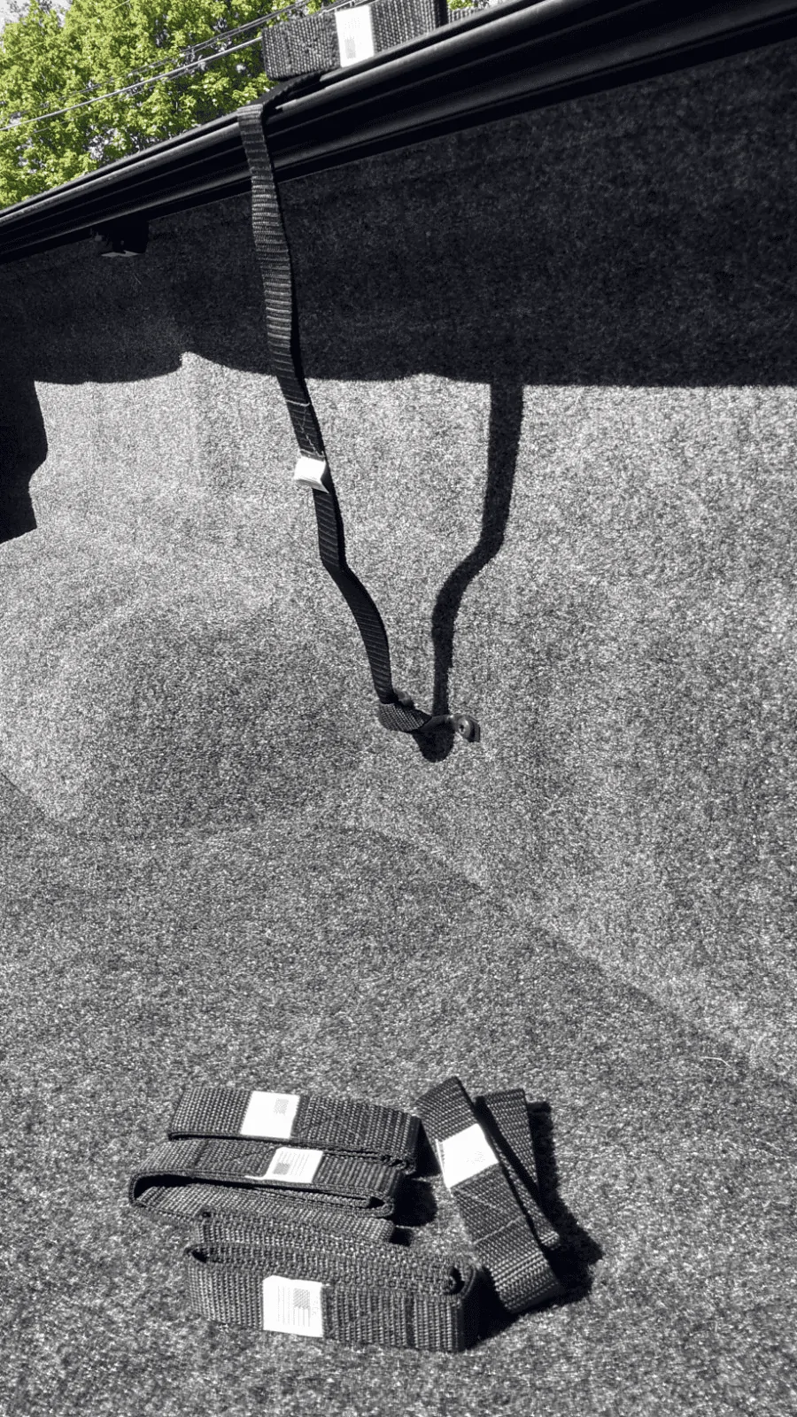

I use 24-inch soft loops to extend the tie-downs so that I can clip it after loading (because I often think of that later, derr) and I leave them in all the time. I just got some more so I can double them up for longer reach allowing me to clip at the first one or the second one. Looping them together lowers the breaking strength of the second one.
They aren't very strong (supposedly 1,200 pounds) but are US-made and great for keeping stuff from shifting too much.

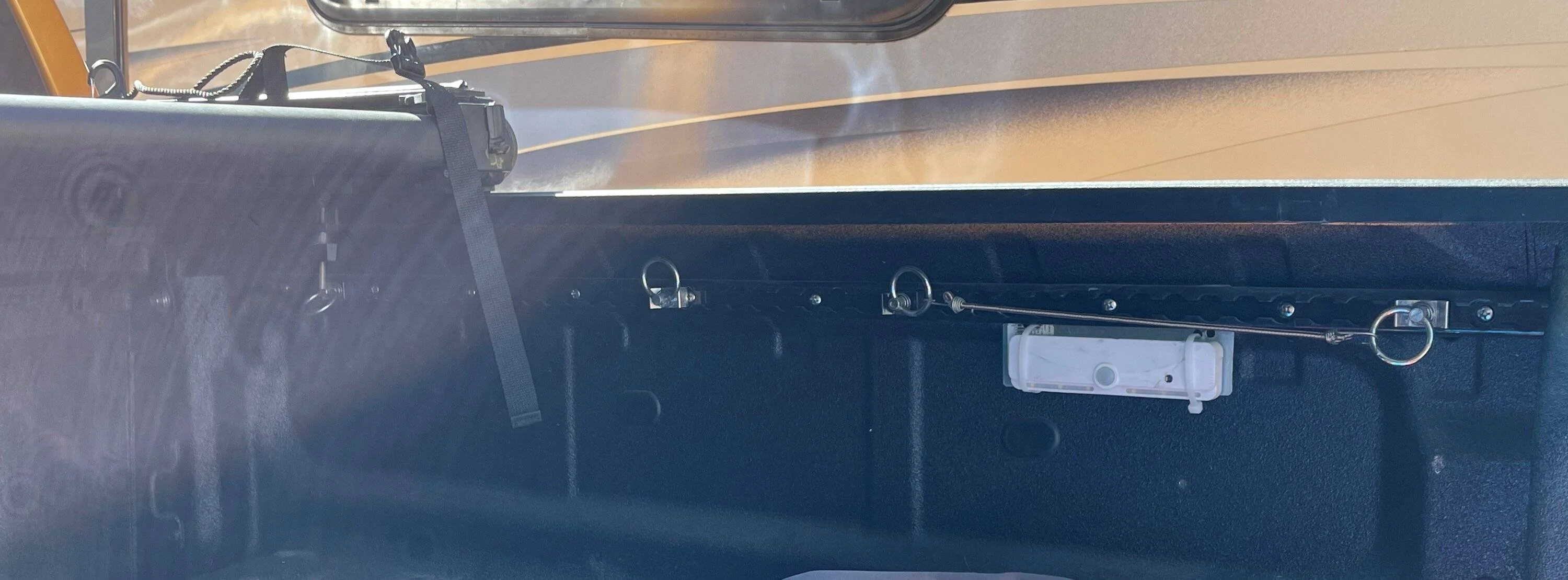

I have M8 eye bolts in the font 4 above the tie downs. so up front I have 2 eyebolts and the tiedown on each side.
I also keep bungie cords in mne all the time for quick tie downs. makes it quick to lock down say a gas can or propane can. and given NH weather I filled both this week.
