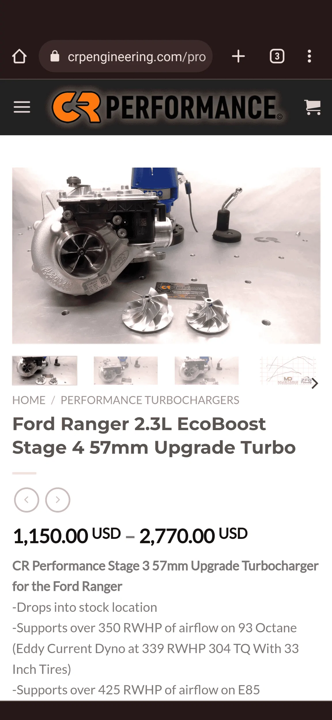

Performance person
I just ordered an upgraded turbo for mine. FYI the stock turbo is pretty cheap brand new and should be a few hours to install, there is a little filter in the oil feed that needs to be replaced or you might damage the replacement unit. If you go with an upgrade don’t forget that they require a specific tune to work.
