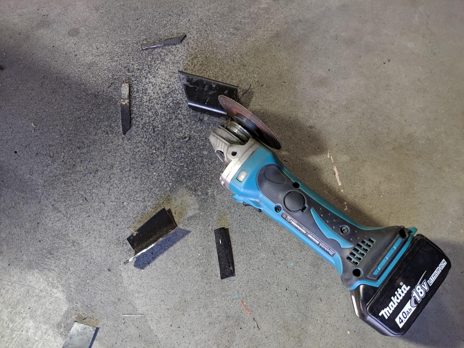

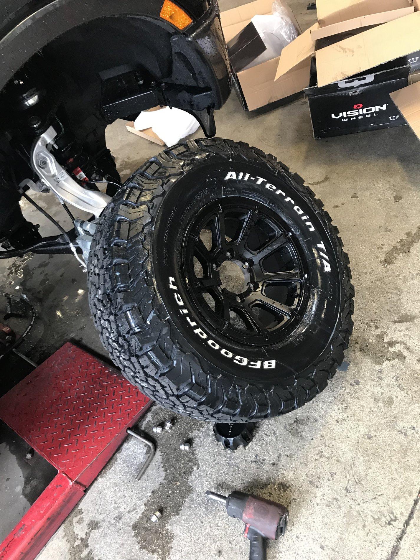

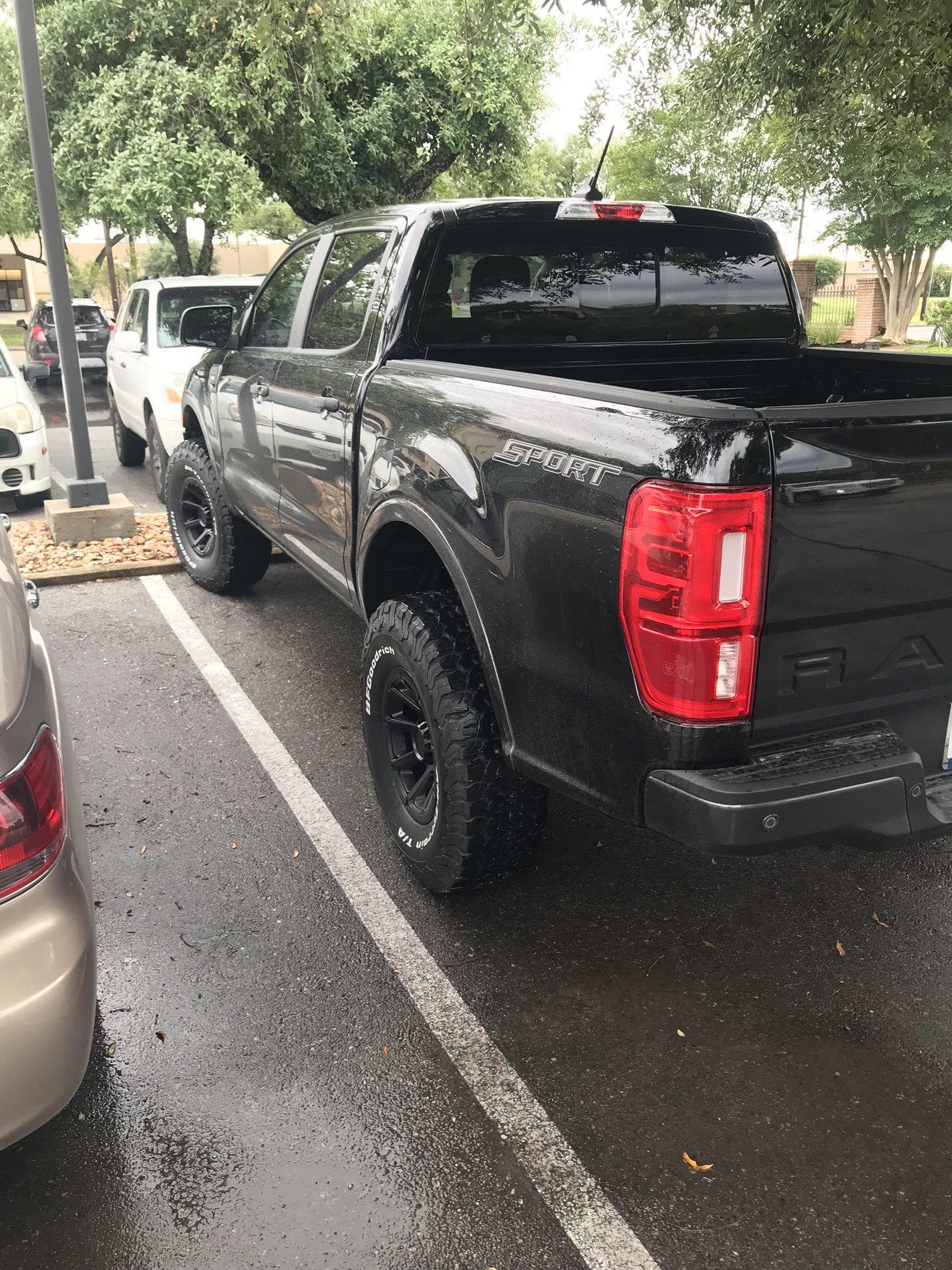

Too tight to cut it with a Sawzall but you can get at it with a grinder/cut off wheel. At least I don't think so. It took some finessing with a cut off wheel.

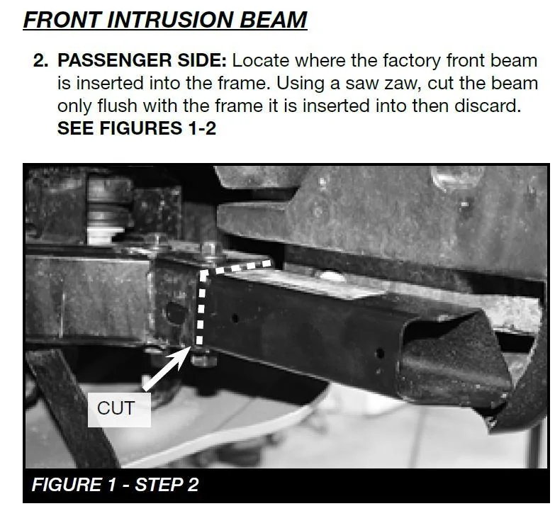

The Fabtech instructions for their crash bars actually say to use a SawZaw. While I myself used an angle grinder, I actually think a sawzaw would have been easier is I owned one.
WH_a-ZRUwai6enre8IrtI8vWA8F0361IHkzTtUwf3XDgHdpaPJHjKZIg_C9erD4pqfNftfewevbCmpMt-8K=w293-h220-no.jpg
BjWRO9KiXHOQP4ONGpa13Y_DdGXXzl3j92p3bgGdaysH7vsO52bURx_4KoQ2LzAuAVLny5udVo8A9Vz-b=w2390-h1792-no.jpg
Did you have to take tire off?
I can't recall where I saw it but one of the lift kit supplier's instructions said to remove the thru bolt and just slide it out of the frame tube. Has anyone done this? I don't have my Ranger yet to try it myself but plan to install a kit when I get the truck.

An oscillating tool would also be a good choice if you have a long enough blade.
You can slide it out if you want to remove the bumper and fender but that’s a lot of work.

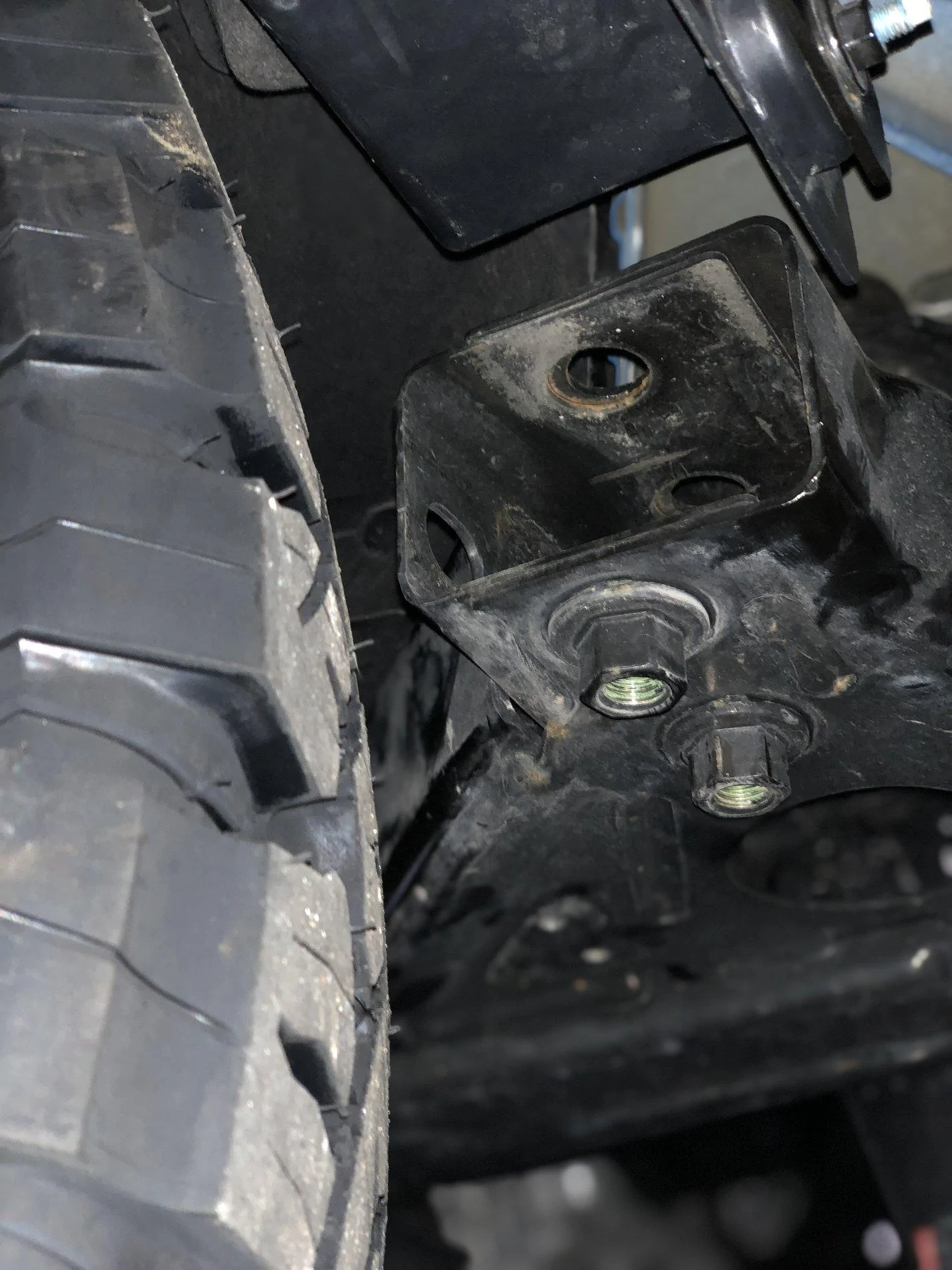

To clarify, myself and others have totally removed the beams my removing the bolts but there isn’t enough room to slide them out. As such, it’s a two-step process. Cut the beams to provide clearance, then remove the bolts and slide out the remainder of the beam. Here it is after complete removal.
Need a pneumatic drill to get those bolts off. They are torqued on there pretty good. I cut the crash bar off yesterday with a sawzall

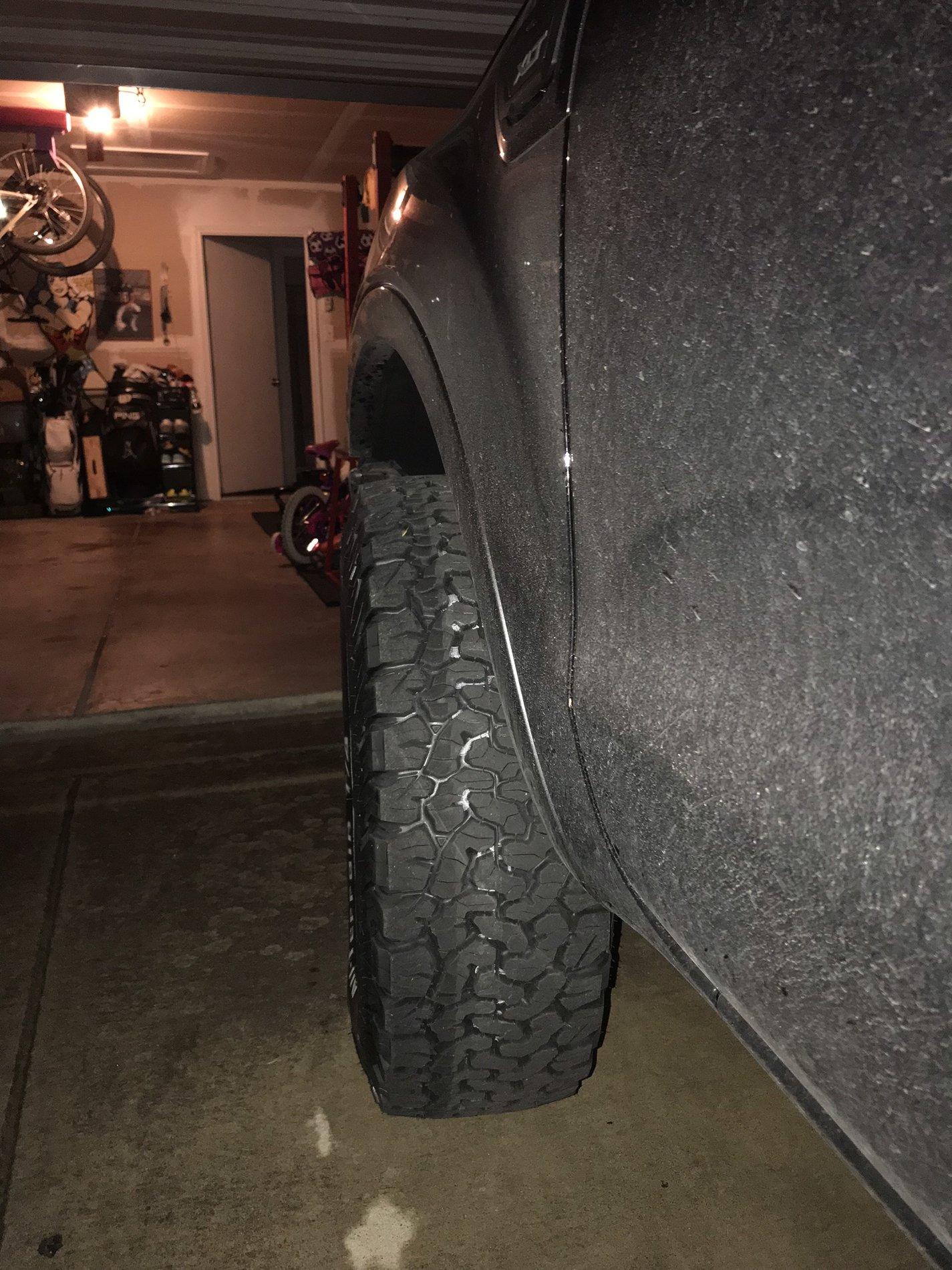

My biggest problem is on the drivers side. I did a 3” leveling lift with 285/55R20s. Passenger side is fine.
