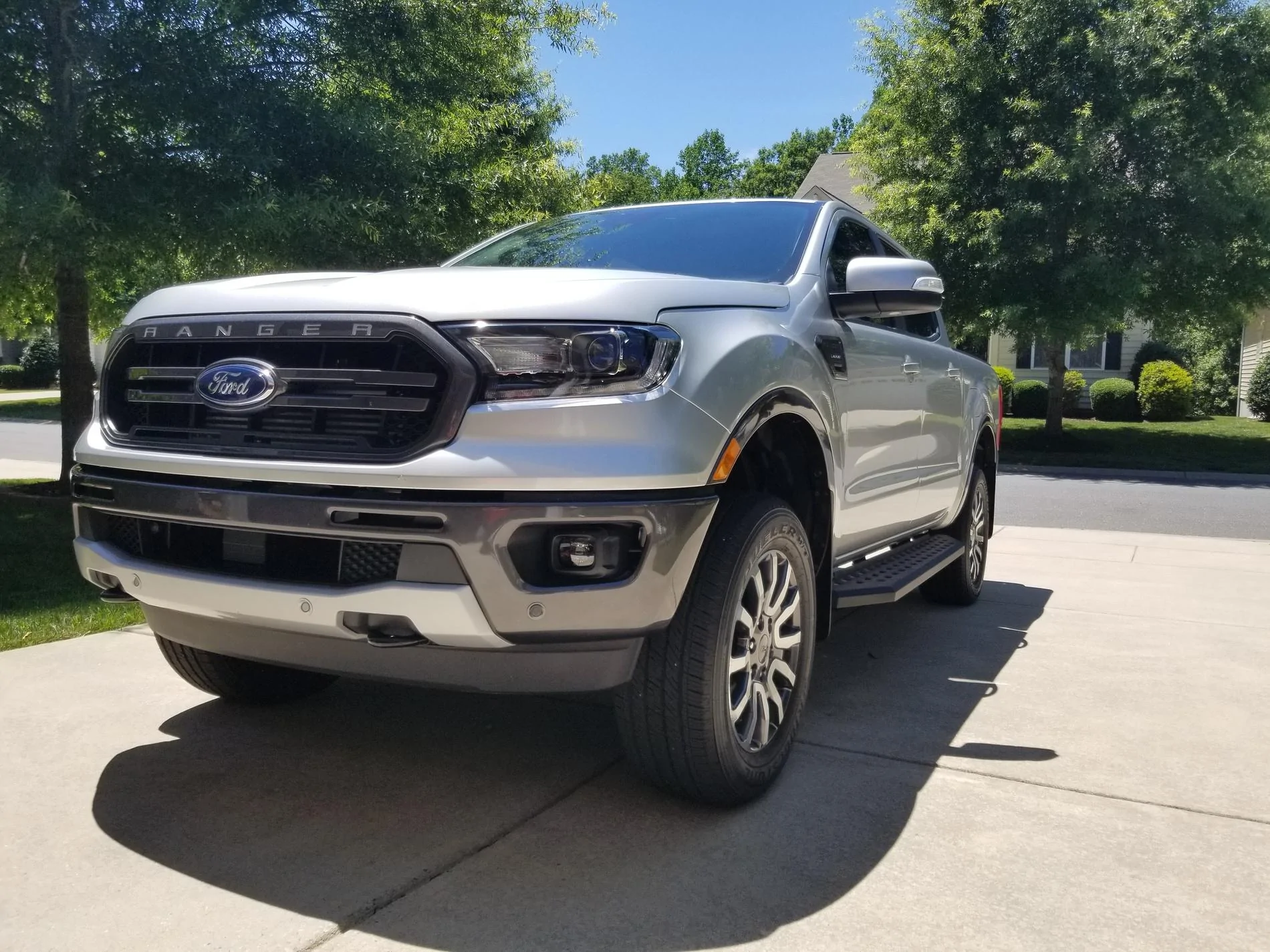

I had the same question I ordered Rough Country 2.5" spacers from @PandaMotorworks. I hated the stance as well. Some worse than others. Having My dealers Quick Lane service center install next Monday,
Same part for 2WD as 4WD

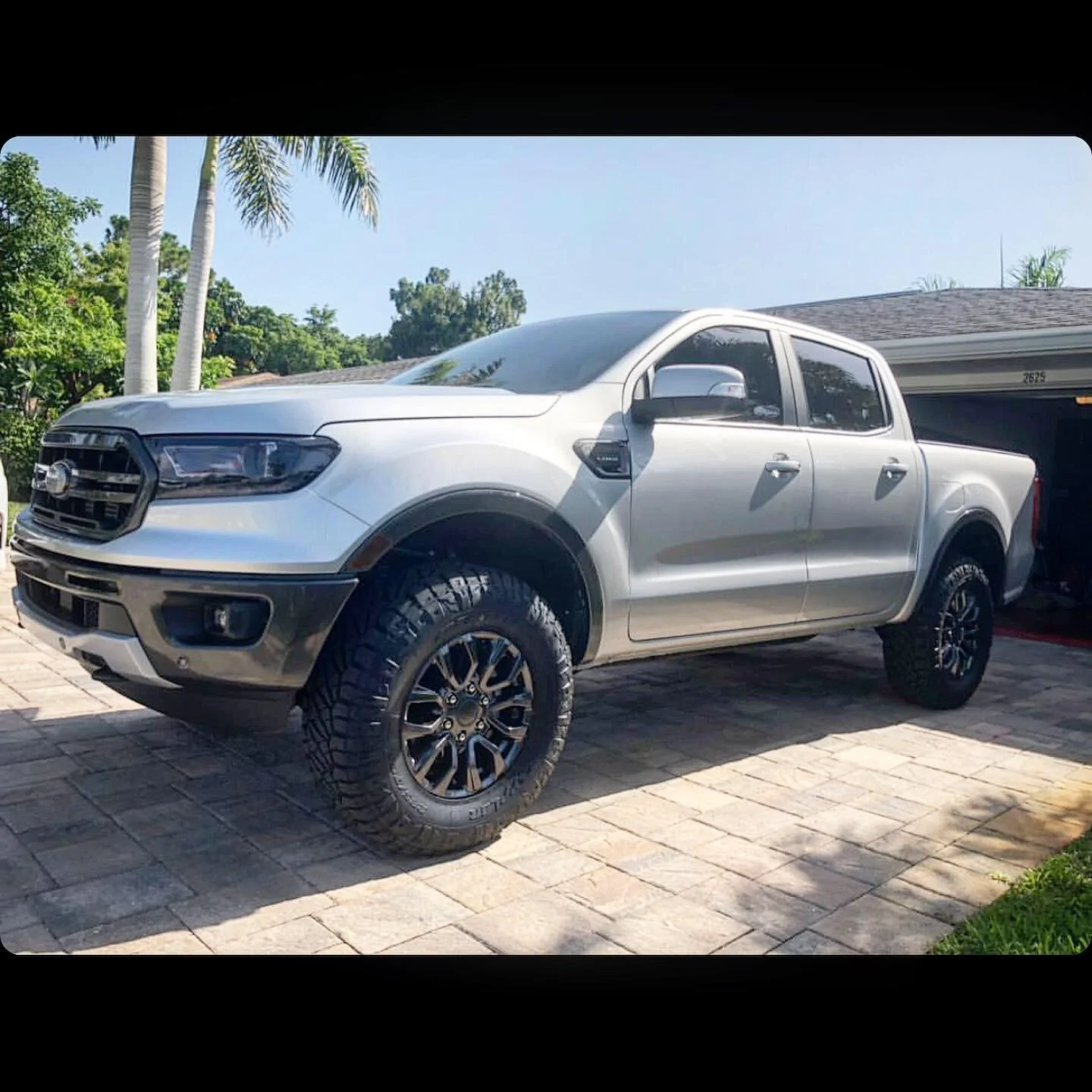

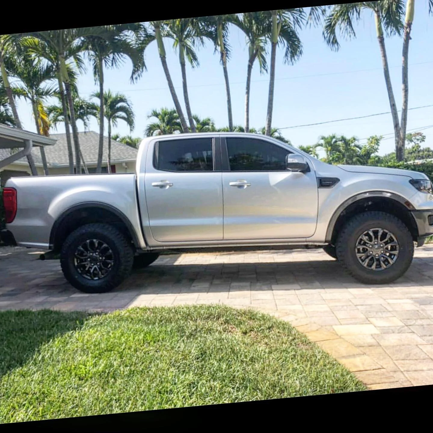

13 Second Ranger
Jul 17, 2019
155
241
West Palm Beach
2019 Ranger Lariat
Ford Quick Lane is doing mine. problem is they don't have the software to do the alignment afterward. I am waiting for their call when they have the software to do the alignment. I would rather wait than have them do the lifts then have to get an alignment somewhere else.
I had my local dealer do my alignment after installing the Rough Country 2.5 kit. Couple of hours later and less than $100 and it drives perfect. Sounds like they are giving you BS info.
