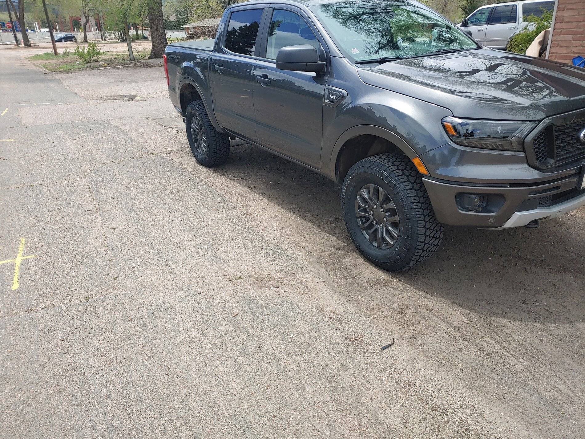

I just installed 285/70-17 Firestone Destination XT'S on my truck today. I have the Old Man EMU lift and stock wheels with no spacers what so ever. On the street they do not rub. Offroad..... Well I will find out tomorrow but I think I will be fine.

So an update on my end. With the Old Man EMU lift, 285/70-17 Firestone Destination XT on Factory Sport wheels with no spacers and using the Swaybar disconnect I only got a little rub turning when fully compressed up front. Simple fix, remover the plastic covers on the front crash bars and move the front crash bars forward. After that its all good. Other tires I can't say

I do not have any rub on the knuckles what so ever but then again I have the Firestone Destination XT'S. To my understanding the KO2's and Grabbers may rub.

I would not be suprised if on the street it was fine. Thay is how my truck is. It was Offroad that I found the issue as the springs compressing into a trunk would cause issue on the front crash bar. Easy fix to say the least.

Simply loosen the bolts for the crash bars and push them away from the tires. After that tighten them back up. Don't be surprised if a few don't move.
