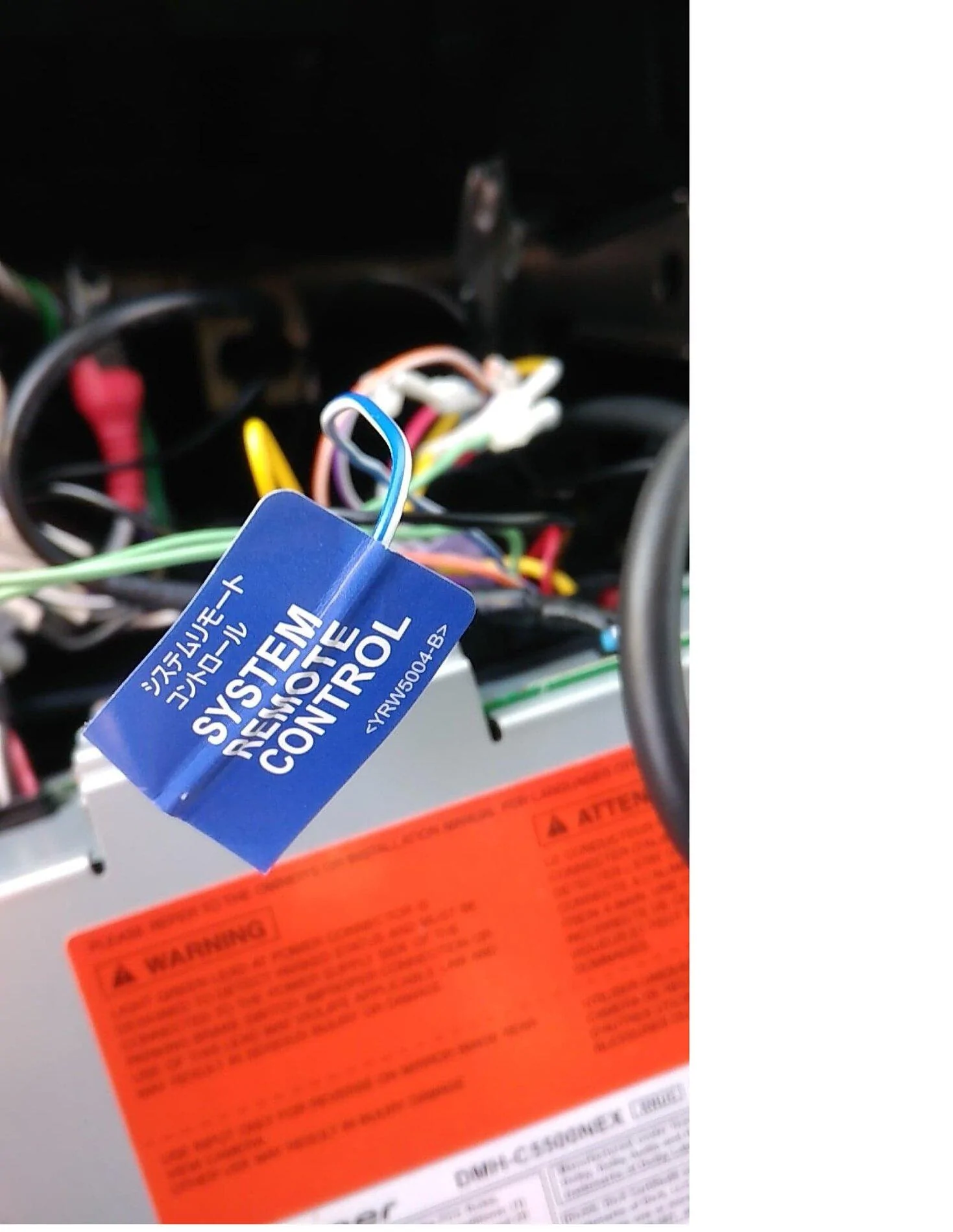

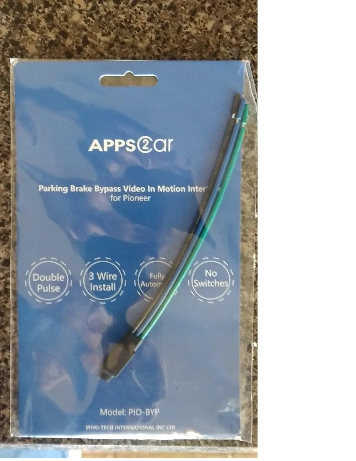

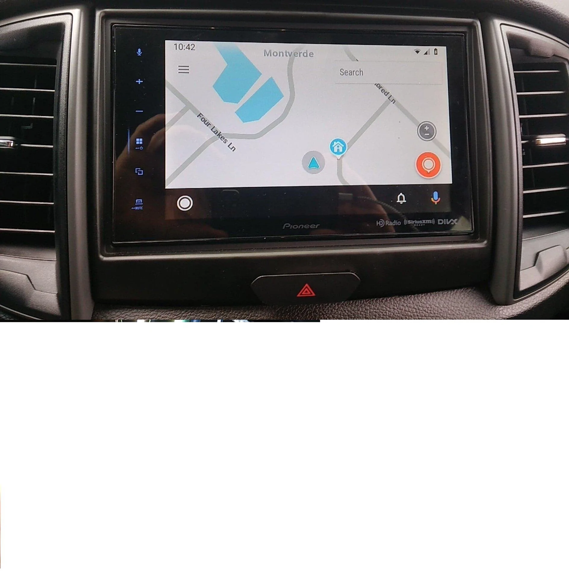

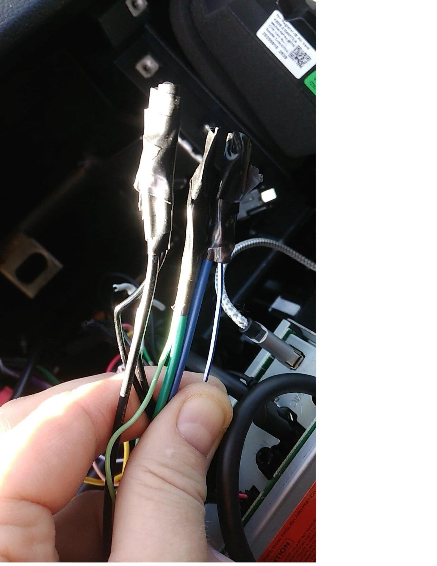

Pulled it out one more time to get the usb / Android auto finally working... I did need a high to low toggle on the Pioneer parking brake switch line to enable my usb port . I bought this toggling chip device off Amazon for $10 . Its a 3 wire connection so I soldered black to ground, Blue to Blue / white Stripe (system remote control wire which is +12 on the Pioneer as I read it with a voltmeter ) , green to Parking brake green wire on the Pioneer . Some older Pioneers I guess you just needed a constant ground connection on that wire and it would work but in the name of safety the manufacturers have gotten wise to guys wiring it that way bypassing it and now you need a +12 to ground toggle pulse in order to work. All in all a pita lol. Hope this post helps others on this type of install......This old guy will never do another one of these upgrades ;) .
