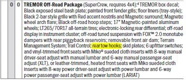

I just realized the 2021 Tremor Pkg includes rear tow hooks.
If someone has information on this please post. If someone has a 2021 Ranger with the Tremor Off-Road Pkg, please post photos of the rear tow hooks.

Tremor Package does include them, but they get removed with the Tow Package. Who has Tremor without Tow? I don’t.

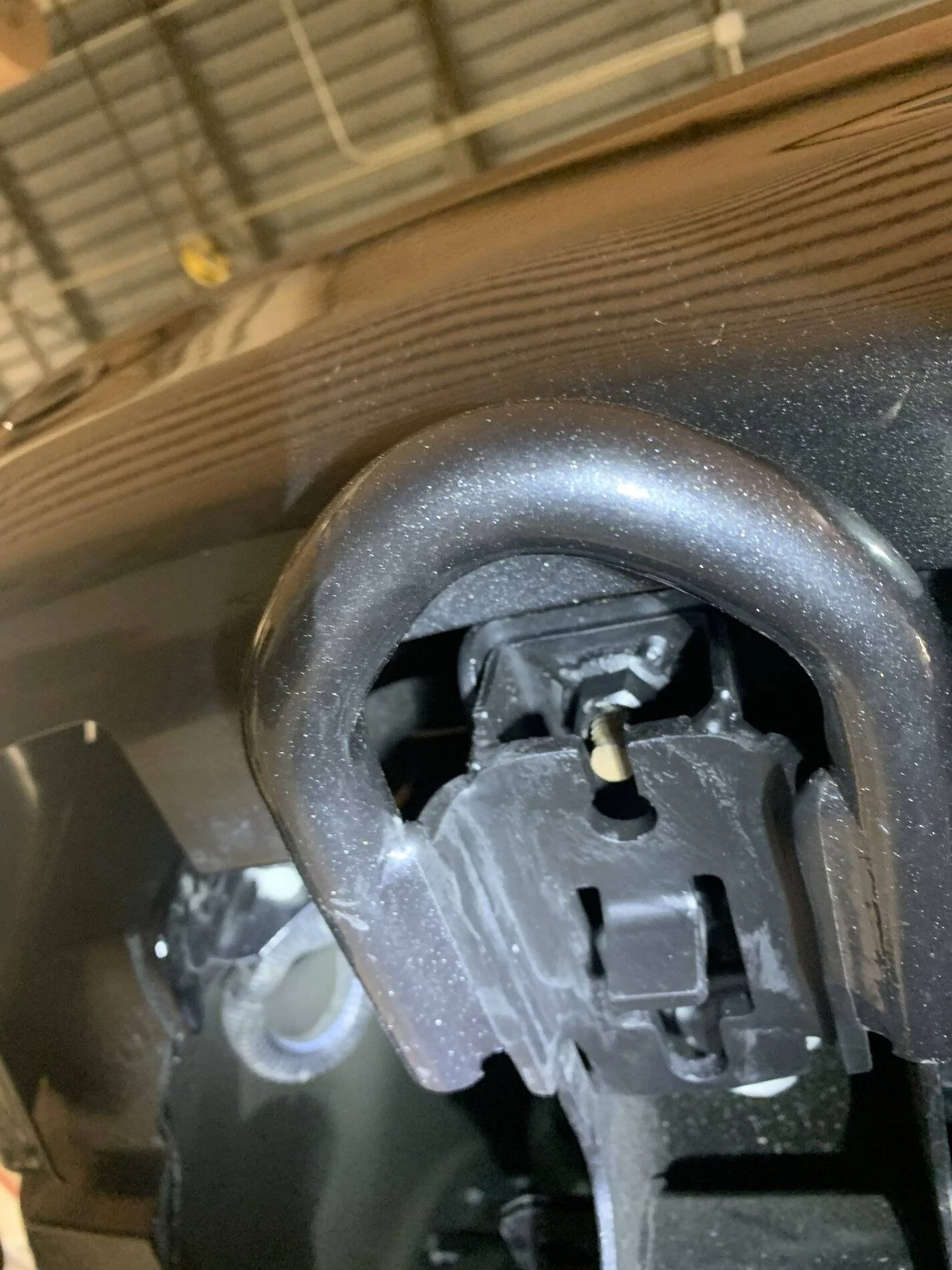

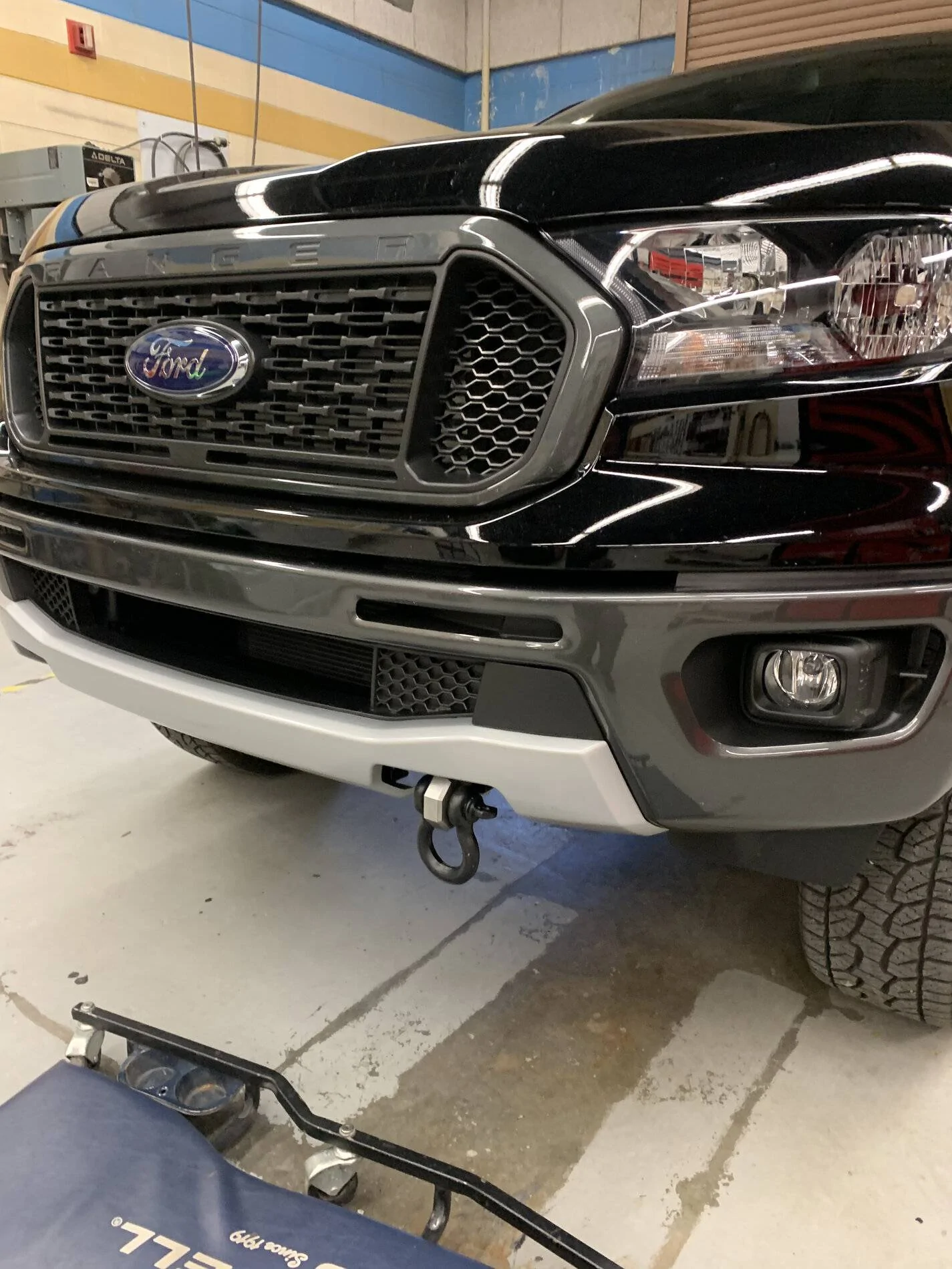

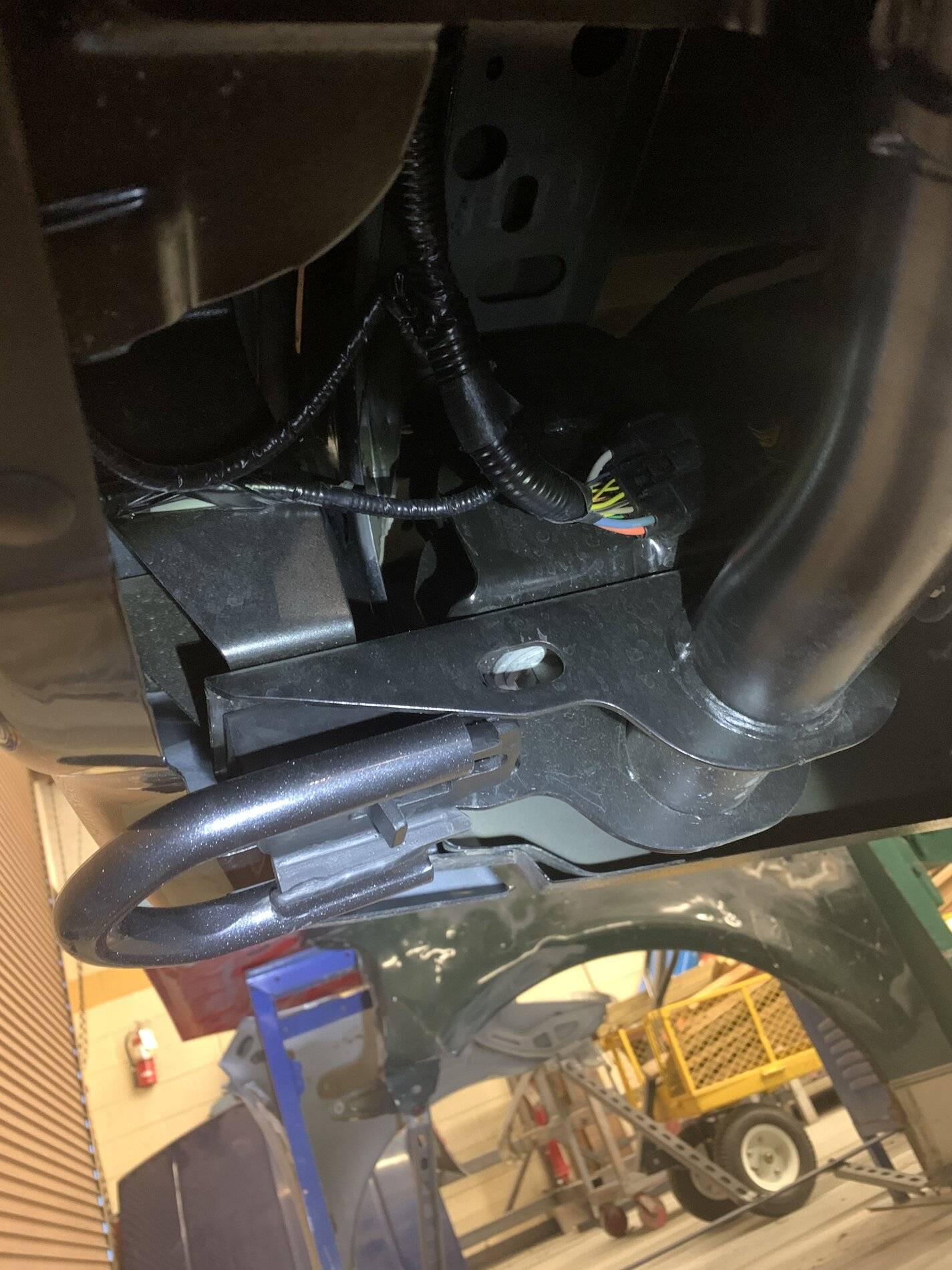

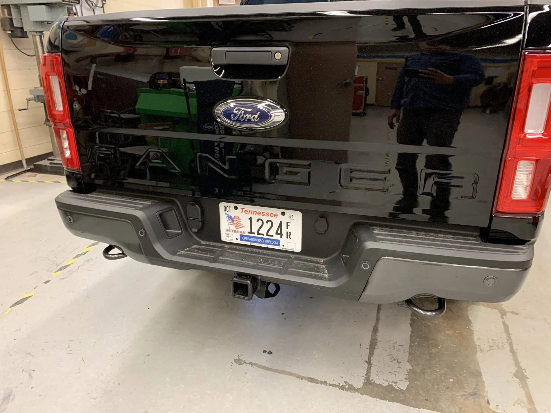

I made me some front shackle mounts and repurposed the hoops as rears. Painted everything Magnetic for a nice clean look. Not gonna say it was easy but turned out nice.

yes, the rear hooks are deleted with the tow package because they don't add any functionality you don't get from the hitch receiver. (and the hooks and the receiver are mounted to the same thing, so the two options interfere with each other.)
So if I'm looking at this right you welded a piece of square tubing to the top of the hooks and bolted that to the existing hitch mount? Have you tested this for strength/durability? I'd love a set of tow hooks for the rear as my hitch will sometimes have my bike rack attached.
Yes that's exactly what I did. I ripped a piece of thick wall 2" tubing and welded it to the modified front tow hooks and bolted em up in the rear. No testing has been done no. I would not want to sling load my Ranger from a Chinook from these, but they are more than up to the task of another vehicle snatching me out of some mud or whatever.
