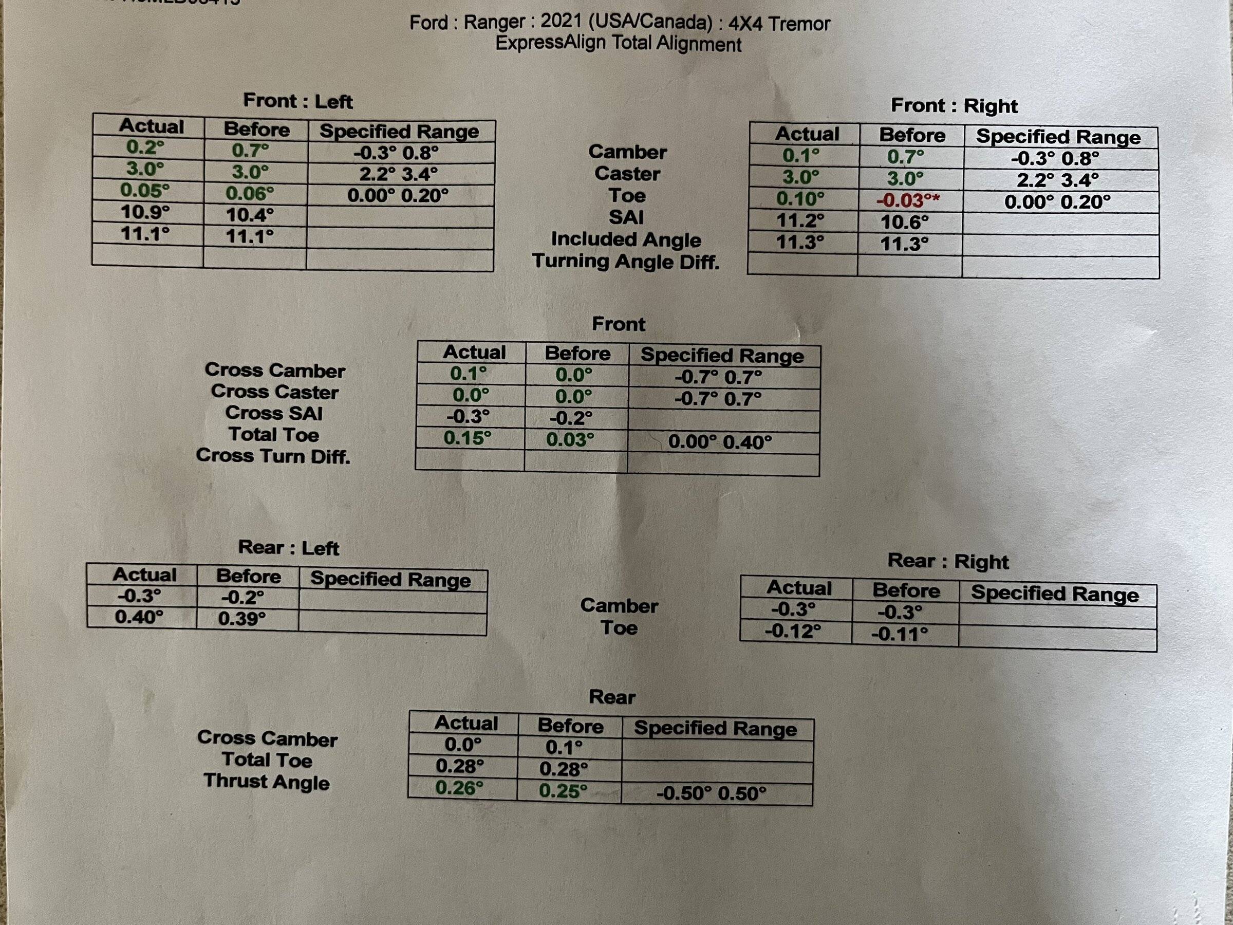

Well, what should have been a simple alignment is turning into the biggest pain!!!
3/14 Monday morning, Got the Tremor 1" level kit installed by Robby himself of Ford Ranger Lifts, he was awesome to deal with and knocked it out super fast but being that I still needed to work and pick my kids up from school I figured I would get the alignment checked tomorrow. Drove straight and all but dont want any needless tire wear or weird issues while towing for example.
3/15 First shop I call said bring it in, so I did at about 8:30, waited about 30mins for the alignment tech to finish a balance job. They then warned me their rack has issues with trucks sometimes because their sensor is too close to the rack but assured they have 2021 vehicles in their Hunter system and see the Tremor in there. They do an alignment check and really was not bad at all, only caster on the left was out by 0.3* but wanted all the settings cleaned up so they proceeded. Turns out the problem on their rack surfaced once they lifted it up, they lost communication with some sensors.
Go down to tire manufacturer/tire shop that starts with an "F" next, too busy to get me in by this point before I need to get my kids so we set an appointment for Wed 8:30am. They assured me they have the right vehicle software.
3/16 Show up at 8:20am, told the guy please verify Tremor is in there as it has different specs from the FX4. He said no worries, it will be taken care of. Alignment gets done, All I see is 2019-2020 4x4 on the page....ugggg. I dont have time to deal with this, whatever, all the specs seemed good anyway. Get in the truck and no joke, steering wheel is a good 10-15* off center. Go back to complain, I now have to wait because he pulled another car on the rack. I told him about the Tremor not showing and he said its the newest software Hunter has....which is a lie, my buddy in CA has a Hunter and has the Tremor as well as the first shop. At that point due to being lied to I just politely ask for my money back.
I then go to my fav coffee shop to find another shop, next one says they got 2021, bring it in. Nope, they did not. Thankfully it was only 2miles of wasted fuel. I called darn near about 8 shops and none of them had 2021 vehicles in the system. A-Alignment which 2 shops actually recommended is almost 2 weeks booked. Two Ford dealers are booked till next week on alignments. Findlay Customs said they can do it but need the truck all day which could turn into a Plan C for me. I think with Findlay being a local dealer chain, they just take it to Ford and get bumped in line.
FINALLY find a shop that said they can do it so now I have an appointment tomorrow 3/17 8:30am and I am hoping the receptionist was right. A local speed shop did mention them too. I figure worst case they can enter the specs my buddy sent me a screenshot of off his Hunter. I mentioned that to some shops and they said either their tech did not feel comfortable with that or that they could not do it.
Plan B is to try another shop on the other side of town. Their location close to me said that shop has 2021 software which makes sense, it is a new location.
3/17.....TBD

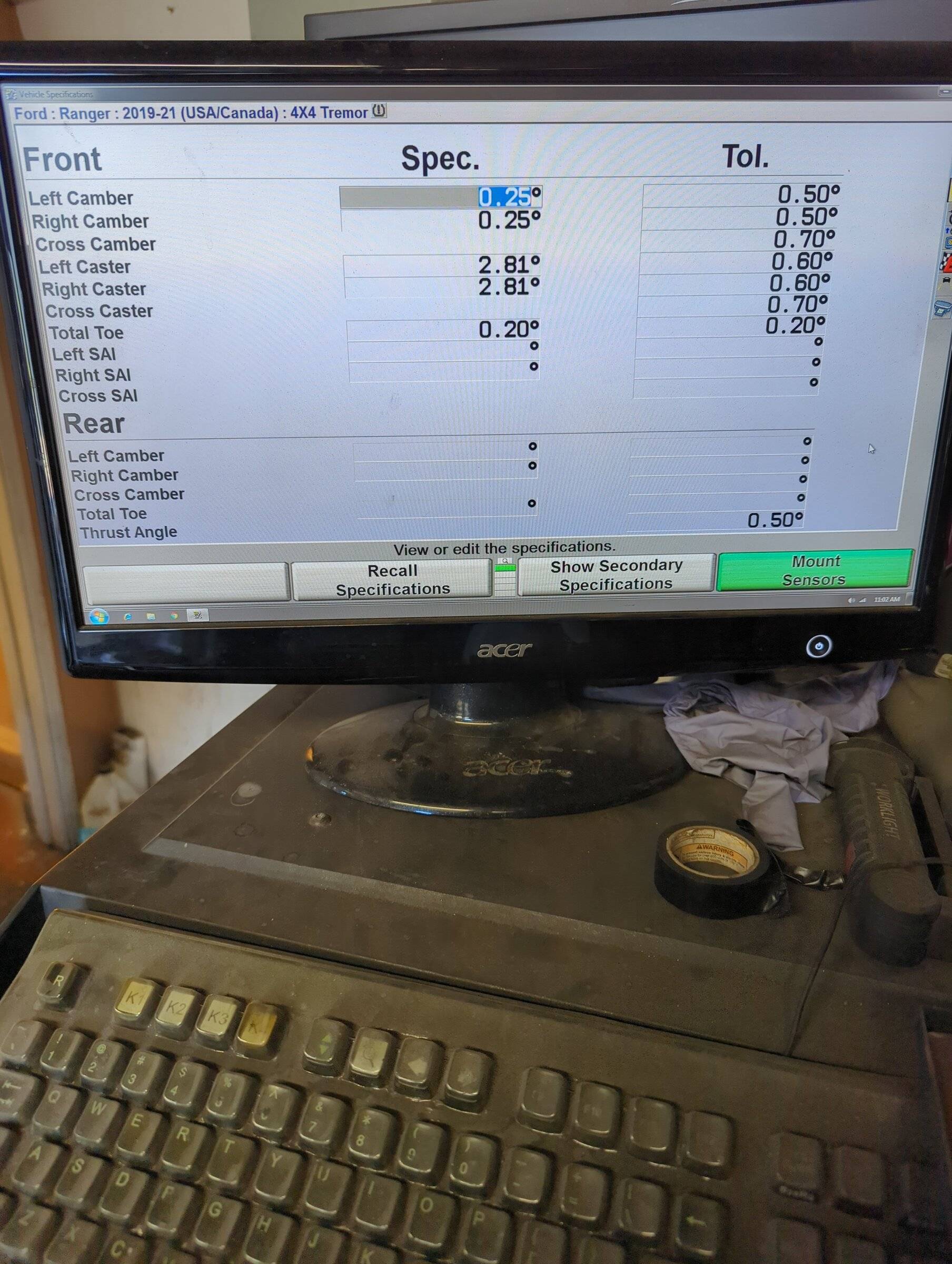

The Tremor has different specs. Has a little more caster and toe. Not like it is a drastic difference but Ford has it different for a reason.
I took this with me to the alignment shop … I got it off the site from someone that shared it.
Thanks, Yeah my buddy sent me a picture off his Hunter alignment machine, the shops that could take the truck in told me either they were not comfortable doing it or their machine doesn't let them do it (which is false).
