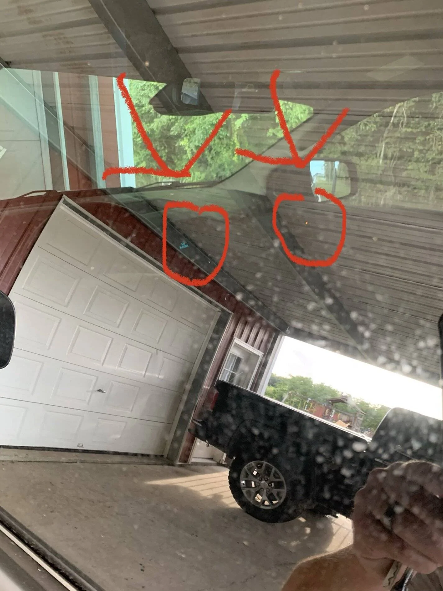

I was walking by my 2021 Ranger XL and noticed the radio display was displaying the time and date. Also the door lock buttons were lit up. Truck has been off and parked for a while. Has this been discussed yet, or do I have an issue? I’ll attach a picture, looking through the driver’s side

If the doors are locked then the door lock buttons will stay lit. Since we don’t have manual lock levers this is the only way to indicate your doors are locked I guess. The radio clock should probably go off though

It’s off now. What I think happened(and was able to replicate) was I opened the Ford Pass app recently and it linked up. When I open the app, I can hear the fuel pump prime and the door lock button illuminates and the clock with date turns on.
