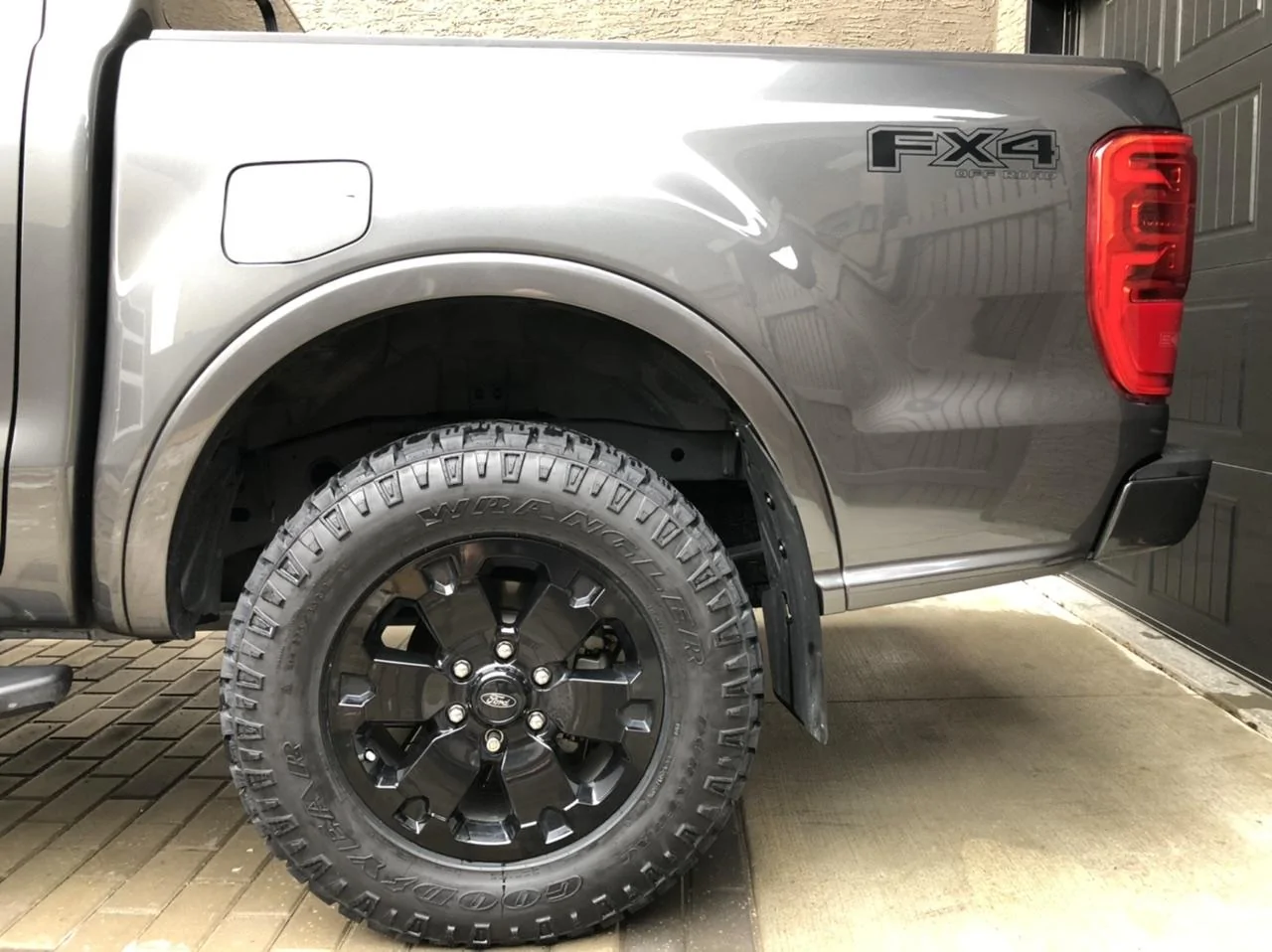

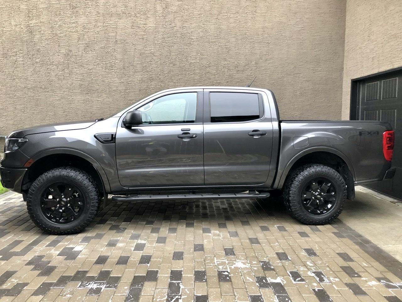

Thank you! Did you need the spacer to prevent the tires from Rubbing??
I think they are fine without spacers, this was strictly an appearance thing.
I did also loosen off the front crash bars and pushed them all the way forward and then retightened. I gained a decent amount of extra clearance just doing this.

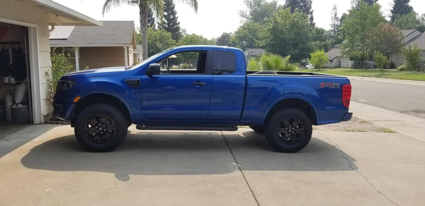

Just got back from the tire shop. 265/70R18 Falken Wildpeak AT3 on the black package 18s with a Ford performance Fox 2.0 kit.
Wow that looks awesome. Looks like you still have crash bars in tact too

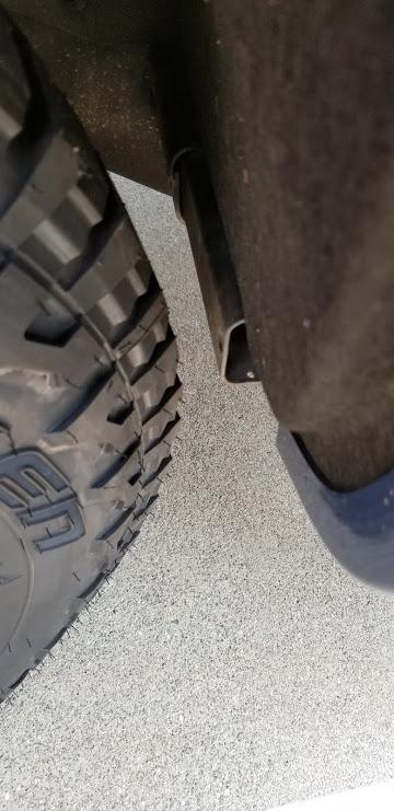

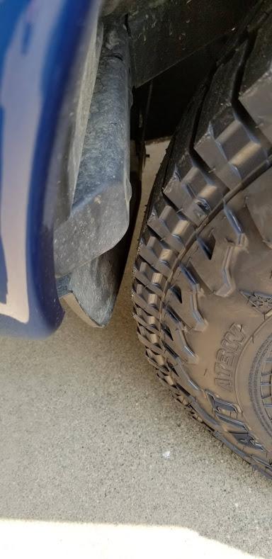

Here is the two clearances on the drivers side with the wheel turned as close as the tire comes to the crash bars. I did not adjust them, this is the way it came.
Front,
Rear,

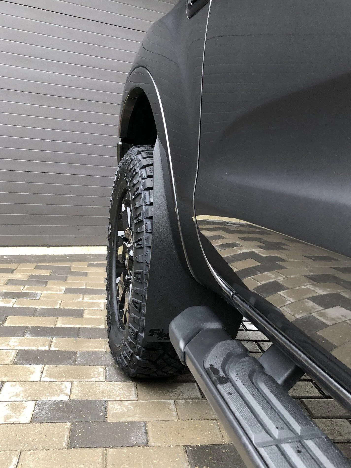

Here’s a different angle. Keep in mind I’m running a 1” spacer with these rims as well as a 2.5” leveling kit.
