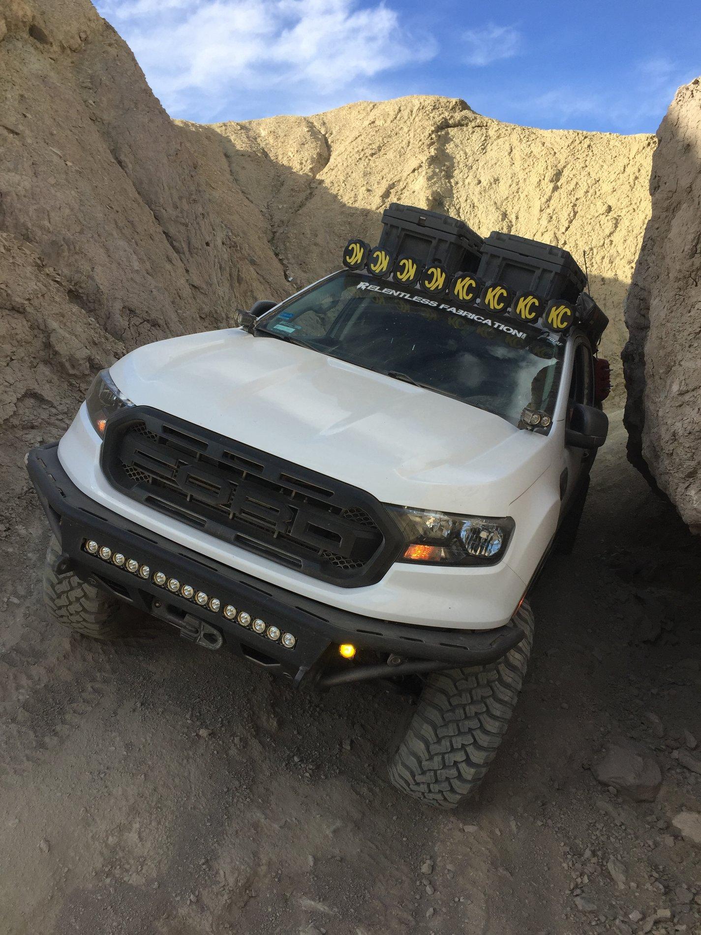

So I kinda dropped the ball on SEMA this year with this truck, BUT I think it would have fit in nicely. I built this for Overland Expo West earlier in the year and just recently became a big boy and put 35s on it.
Probably one of my favorite trucks I've ever built that literally goes anywhere. Just got back from the Roaming Lost Cleanup where we got some AMAZING photos.
Enjoy!

Looks great! What had to be done to fit 35’s?

Surprisingly not that much. At least nothing I thought was outlandish. The first thing is cutting off the factory crash bars front and rear.
Secondly, making sure you have the proper lift. I did 3.5" lift in front with a 1" block in the rear and add a leaf. The back isn't ideal but until Icon releases their RXT Leaf Pack or I go Deavers, it's what I am using.
