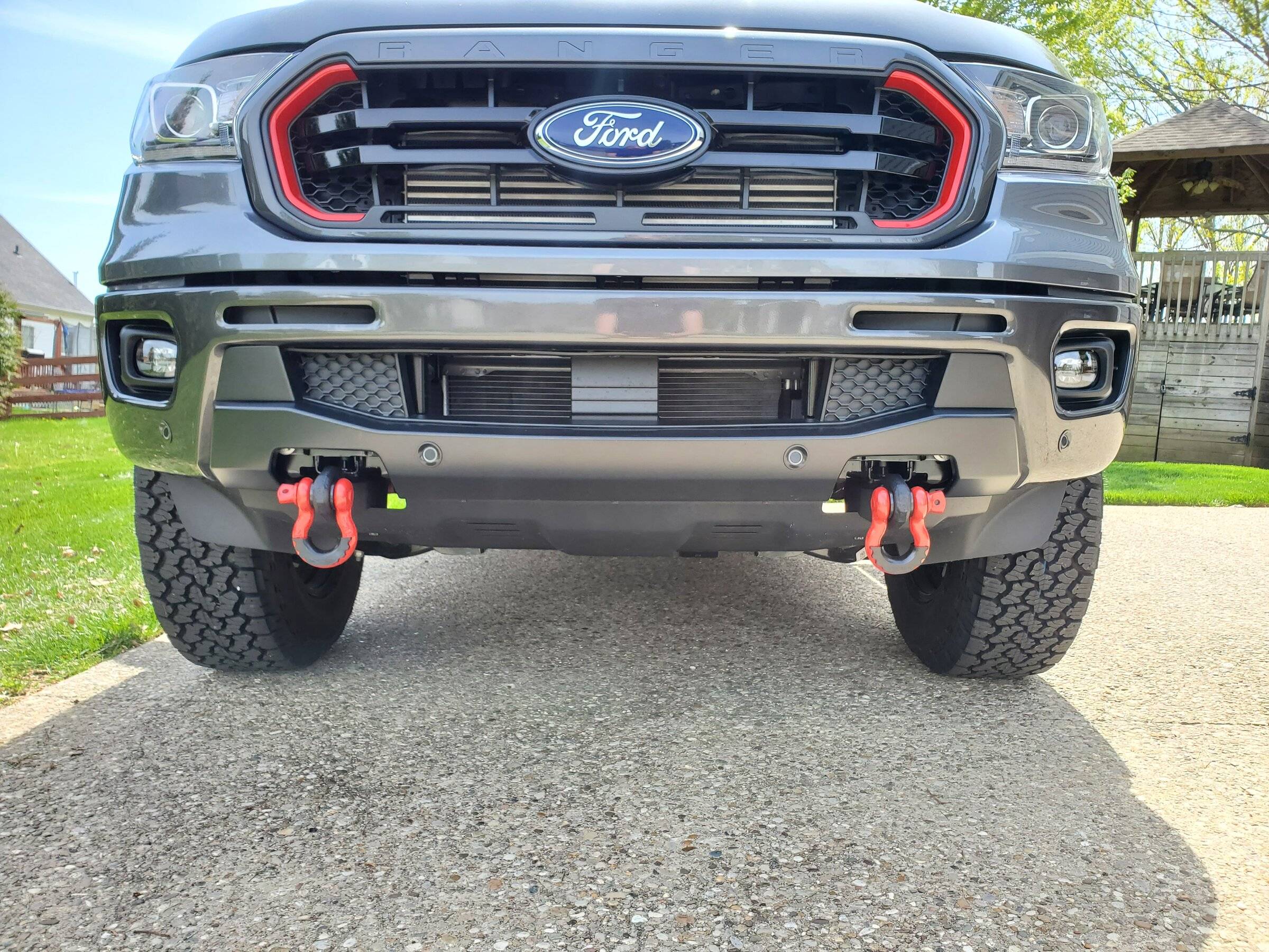

Just installed these on a 2021 Tremor. Modification is required to the front holes on the skid plate. I had to drill a new hole on the passenger side since the hole location was off by about 3/8 inward and 1/2" towards the rear. Both hole locations are probably off but I chose to bias towards one side rather than drill two holes.
Same story here. The holes do not line up. I ended up cutting some more space in the rear slots to allow my skid to slide further back. Pretty shoddy measurements by Rough Country, but maybe not too shocking.

I found this thread while preparing to install these on my 22 Tremor. I biased both RC brackets inboard before torquing them down. That took care of the left/right hole alignment. Then a few gentle taps on the back of the brackets with 4 lb hammer fixed the fore/aft alignment. No skid plate mods required. I left the OE rubber trim pieces off for now, but I'll probably trim them and reinstall down the road.

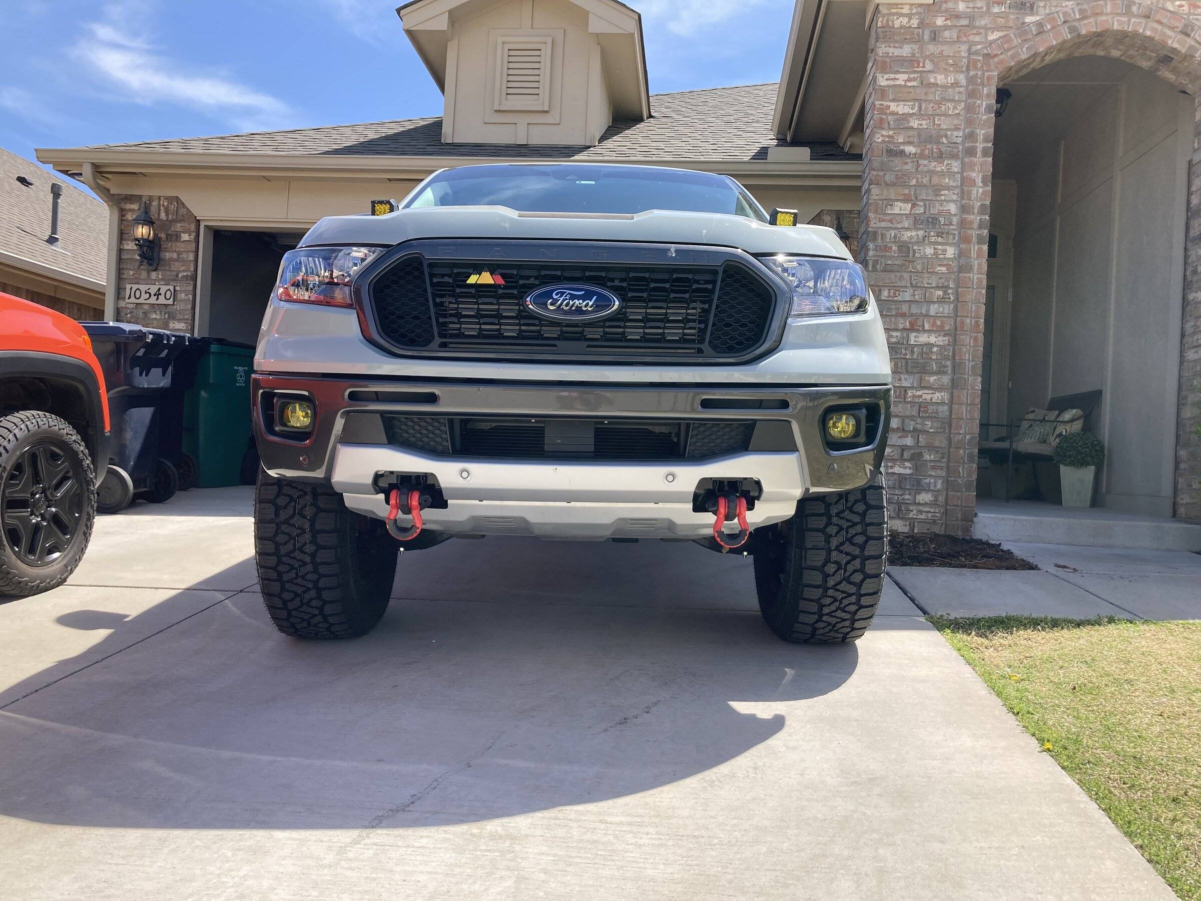

I found this thread while preparing to install these on my 22 Tremor. I biased both RC brackets inboard before torquing them down. That took care of the left/right hole alignment. Then a few gentle taps on the back of the brackets with 2 lb hammer fixed the fore/aft alignment. No skid plate mods required. I left the OE rubber trim pieces off for now, but I'll probably trim them and reinstall down the road.
I’m did the same! No mods required.

Am I crazy or do these affect your approach angle? Seems like they sit lower than the stock recovery points.

I remove the rings when I’m off road. Otherwise no more than a single degree.
