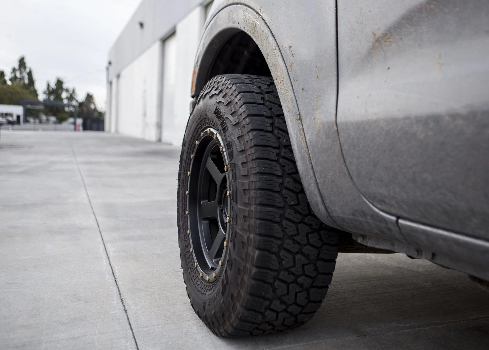

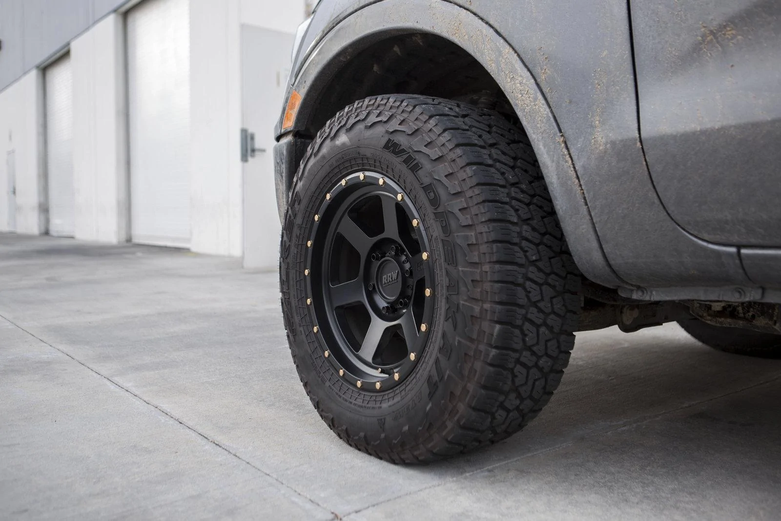

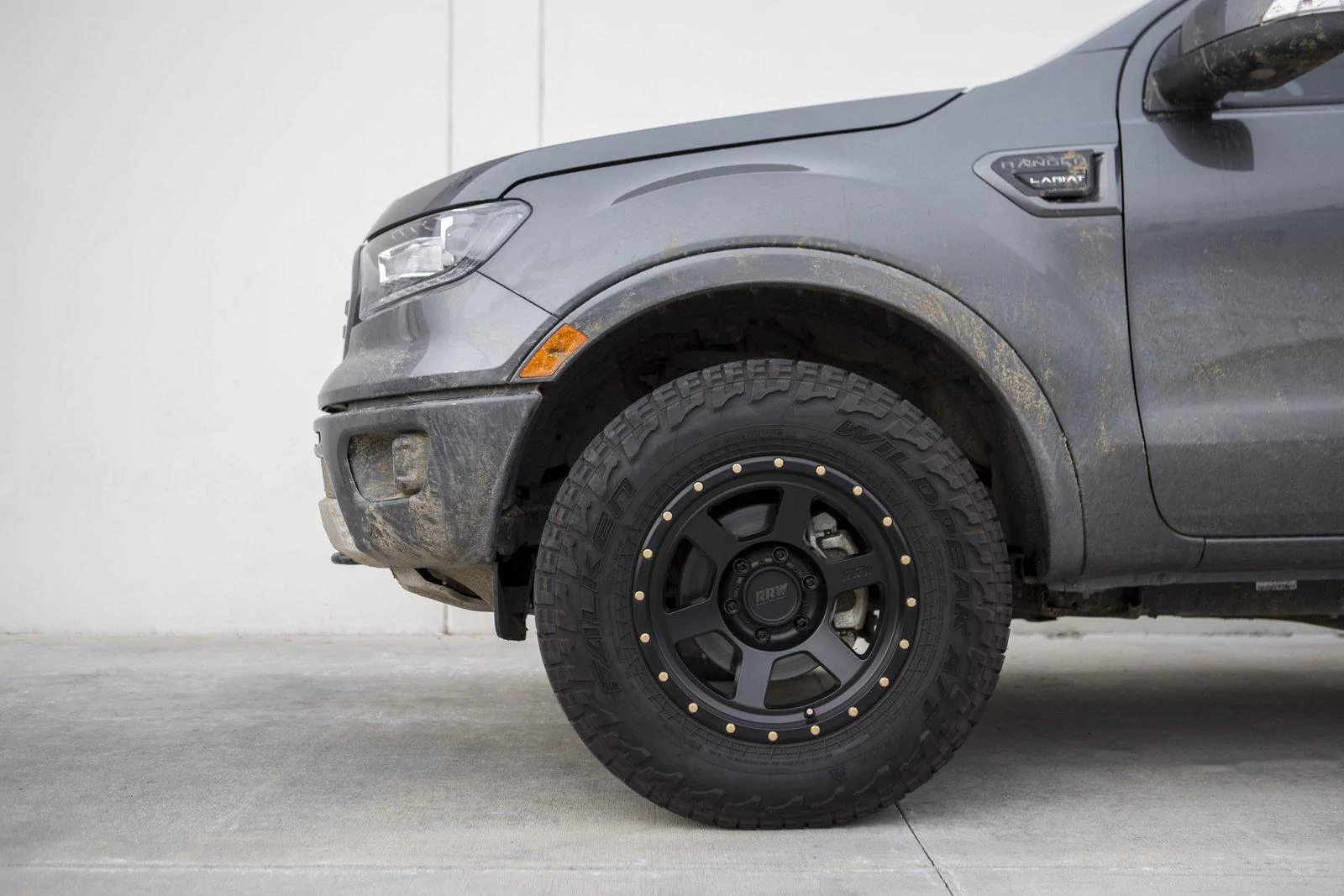

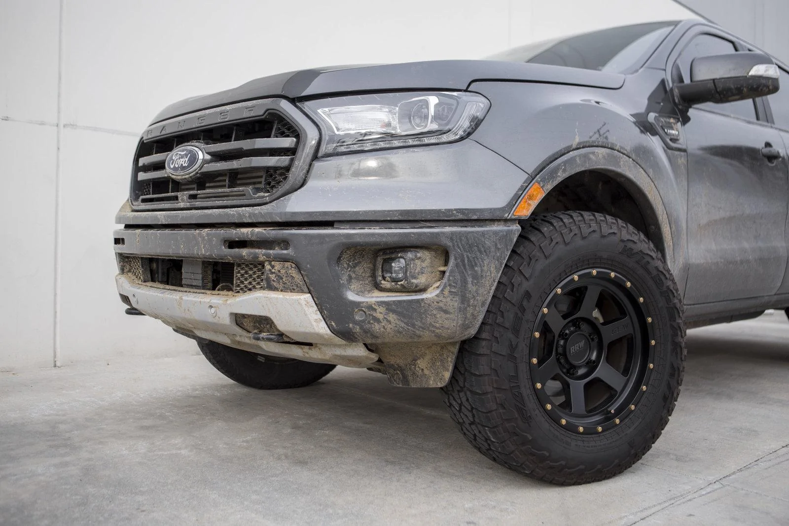

Hey Everyone!
Just test fitted some 265/70R17 on 17x9 +0 RR4-V on my stock 2019 Ranger. Sad to say that a leveling kit would be required to run anything bigger than a 31" on the stock suspension. It rubs the front bumper & body mount at almost full lock.
Just ordered a leveling kit so hopefully, I won't have to do any trimming to make this set up fit properly without rubbing.
But overall, I love the way these wheels look with 32" on. It fills up the wheel well nicely and It immediately changed the entire look of the truck. I eventually want to upgrade to 33" once I get tired of the 32" look.
