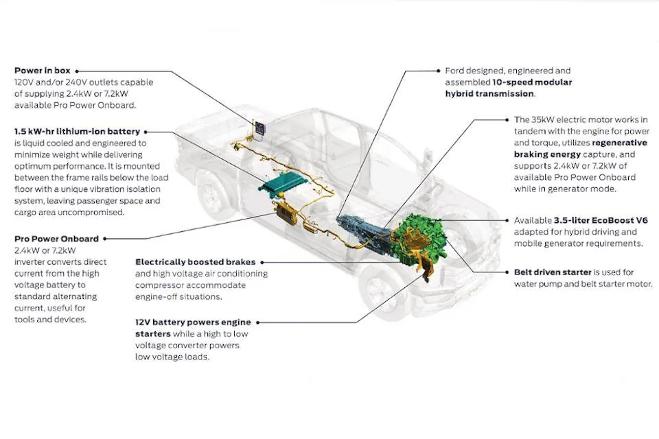

The F150 does not plugin. It uses fuel and kinetic energy to charge the batteries.
The PHEV Ranger will be plugin while also charging through kinetic energy.
It has not been stated if the Ranger will generate power the way the Pro Power F1 50 does.
Pro Power F 150 configuration

It is available on the ICE versions of the F-150 but at lower capacity. I'm not sure, but they might have a second 12 volt battery as part of this option.
This is a good article: F-150 Pro Power Onboard
